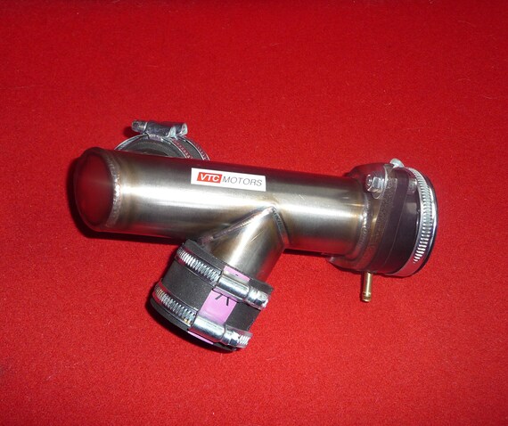

Anyone seen this? Personally, I'm not going to do it. But I figured someone might be interested in a conversion.
I recall someone else on here did a single carb conversion.

I have done this conversion with this manifold . Found the manifold on ebay for $169.00 with free shipping . It came form Lithuania and got here in 8 days .Quality workmanship and fit perfect . I am also using a Mikuni 38mmvm carb . New on Amazon for $105.00 . It fired up on first try , idles ay 1000 + /- revs and pulls good on the road , However is running rich and needs some tuning . My bike is a 1999 vn750 " Barn Find " . It was left in an old backyard shed since 2017, Rust and varnish in the tank and unusable carbs without a rebuild . I think part of the rich running is that all original intake is gone and am using a 5 inch round sportster air filter with all stock exhaust . I think i need to degoat and open up the baffles . I have some pictures I can share when I am allowed to post them . I am new here and this is my first post . I welcome any comments or suggestions

Mikuni Vm38 single carb conversion...been riding this way for 2 years now...custom manifold built out of 1-3/4" Alum. tube, tig-welded...throttle cable by Motion Pro...black silicone hoses, secured by oem clamps...
