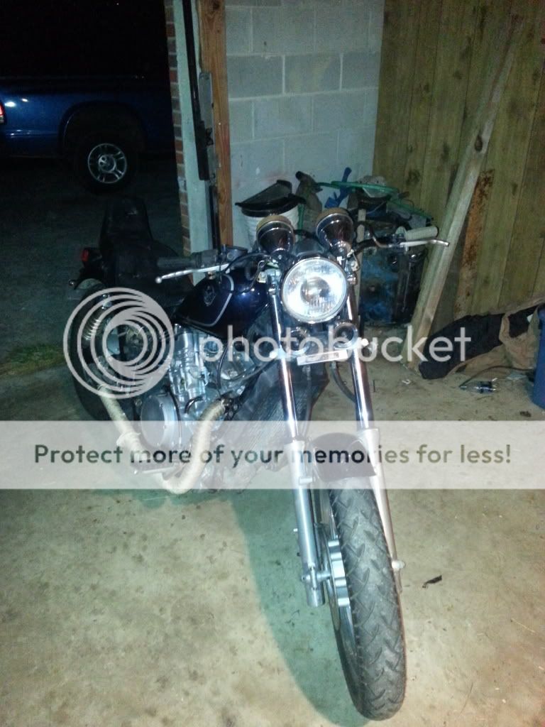

So a big thing with the club bike style dyns out west is motocross bars on risers. I decided to see how the pro tapers I had hanging in the garage would fit. I think they look great and feel awesome. Much more aggressive riding postion, but still not bad on the back. Gonna fab up a mount for the choke cable and hide the signal/high/lo assembly, since I dont use signals anyways. But they clear with about and 1/8th inch on each side of the tank lock to lock.

If you make a set, make 2 and Ill buy one from ya. I'm wanting to do a cafe fairing, and that one looks perfect.

It may be. It feel a lot like drag bars. Im young and still have a good back so right now it doesnt bother me. Ill take the trade off of leaning forward for the much better handling when riding aggressively

Why would we need to put it to a vote? I never said I hated the stock apes or anything. I was simple showing something I threw together in the garage that I thought looked cool and felt good. The apes set me back in the relaxed cruiser postions and don't allow me to be aggressive attacking corners. No I knkw its not a crotch rocket, but its all I can afford and this would be a pretty damn boring hobby if everybody left their bikes stock wouldn't it.

I like what you got on there, I put the Black Daytona Bend dirt track bars on mine as well .Click on my username and you can see my old 750 in my albums with the seat reworked and the Maier sport Fairing on it as well.
As for the survey,I have never liked apes to me they make a bike harder rather than easier to ride,plus the lower bars puts the weight of the bike nearer the core part of your body where most of your strength is. That is my personal experience and also I have noticed that I have never seen any kind of high performance bike with Apes on it on a track dirt or pavement.
use a 1978-1980 Honda CX500 Choke assembly, its a direct bolt on, and easy to hide...
as for your left hand switch assembly, get a dirt bike clutch perch, and delete the whole side if ya want. you can also get rid of the right hand switch assembly by adding in a dirt bike brake res, and throttle assembly.

Thanks man, that choke setup looks perfect. I took the switch apart last night, and tucked it in under the side coil cover, Im gonna mount the headlight switch hi/lo to the cover. The rest is all unhooked now anyways (signals and horn). Im giving some thought to stripped the right side switch and going to a single cable dirt bike throttle with a spring to close it, and mounting the start button and kill switch under the tank somewhere.
