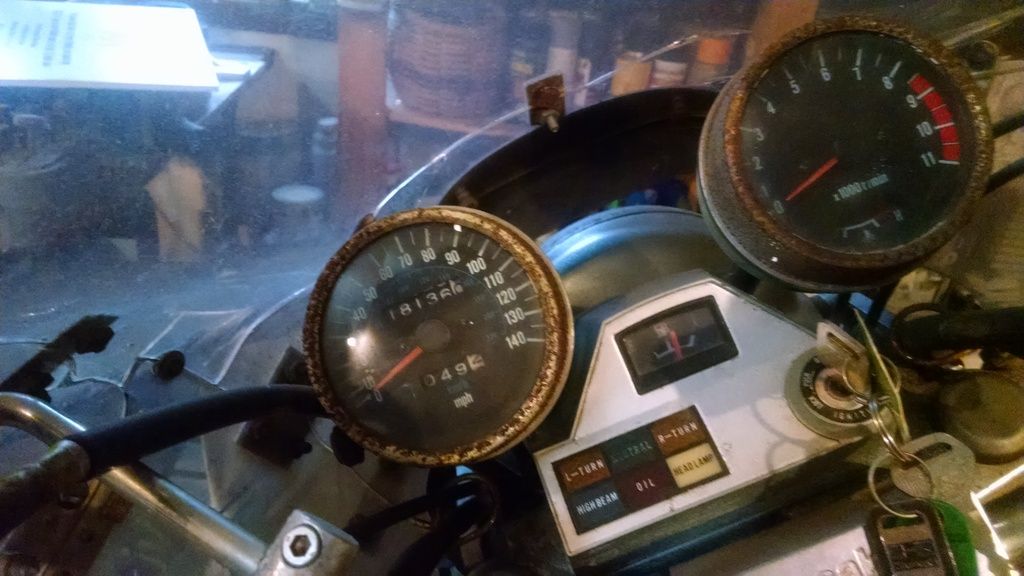

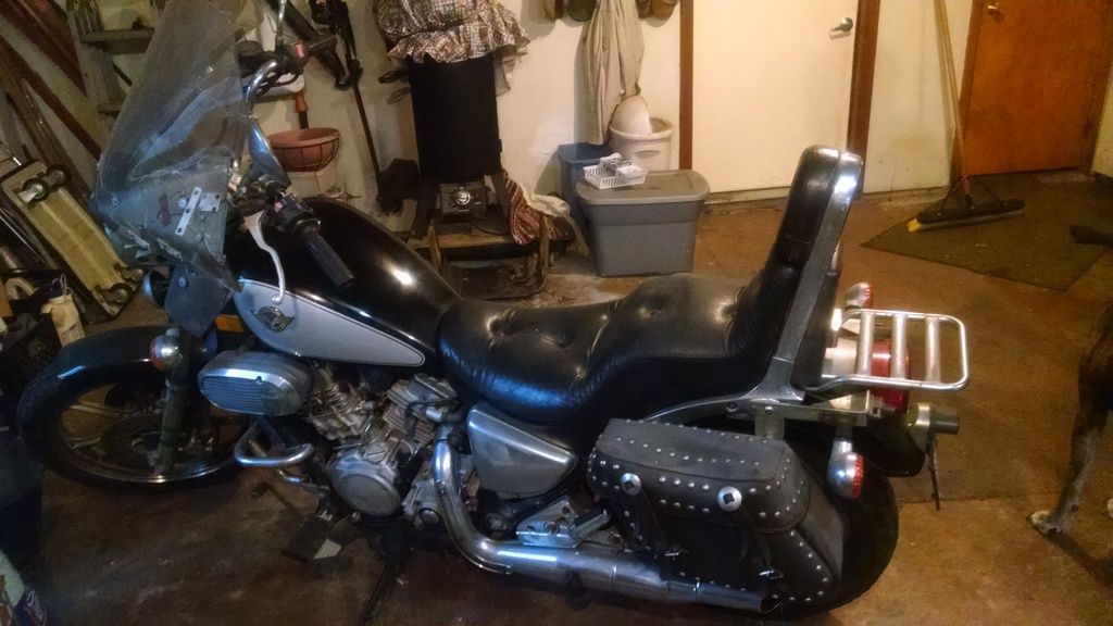

its been sitting for 4 years. front caliper was frozen so we had to pop it loose to get it to load. it needs some tlc, new tires for sure, turn signal stem on the rear, carbs cleaned and a battery. 97 750 18k on the odometer. factory crashbar, signal relocaters , high back rest and some ugly ass saddlebags. i plan on cleaning her up and not modifying her as long as it checks out ok. this will be more of a quiet bike for some of the functions i attend. it will also let me go to town on my 85. $300.00 with clean title

got a chance to tear into her. need turn signal, rear stalks are rotted. master cylinder works and calipers were froze up. i may have to replace some brake stuff but its well worth it. need a new battery. both tires a decent, pirelli's route 66 so im happy with that.

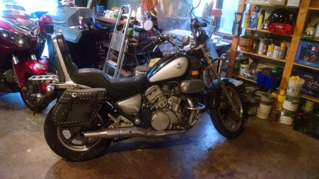

well she runs. put fresh fuel in her, added a battery and it cranked over about 5 times and started. rough but it runs. needs new air filters, spark plugs. carbs should be taking off and cleaned. 13.35 volts at idle about 13.6 at 3k so charging system seems fine. needs front brakes look at. i had to drain all the corroded fluid from the master and calipers, so i need to bleed them, we all know what a pain that is.
head light issue, no power to it. fine at fusebox but nothing at high/low beam switch. took it for a 2 mile ride and was able to hit 70mph but needs some help.

well since i decided to play the game of change the appearance of the 700 i decided to take all the tin off the black bike and install on her. the 900 seat has to be done yet, looking at lower shocks and the 14 inch apes feel great. i ordered a new clutch and throttle cable. rerouted the the choke cable and the switch wires and they work fine. ill probably part the seat and extended back rest, i have two crashbars to sell as well. ill keep the engine for a spare
