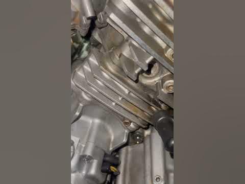

I'm leaning more toward a rod bearing on the rear cylinder now. That's about the only thing that's going to change by removing the compression.
I could tell more about it if I was there with a mechanic's stethoscope.

Just went back and played the youtube videos through my tv. There's something different about this knock, there's something making a different clinking noise. If it has a rod knock, there also something else loose too.
And now I see the oil screen. That's aluminum, isn't it? I think maybe the damper gear is shredding the case.
Put your fingers on the left front of the case and you might feel something there.
10,800 Posts
The metal is metallic.. aluminum is it
that’s a magnet in one picture
Aluminum shouldn't stick to the magnet. And there's no aluminum with the rod and crank, except the piston.
Aluminum would make me look at the damper gear.

Gotta be rod knock goes almost a
just pull plugs engine seemed a lot better out front cylinder back in no clank pull and put rear in… and oh boy it was clanking like no other.. rear cylinder has been back firing a lot also while trying to get this to run.
gotta be rod bearing has good compression”haven’t tested but it’s got it”

Wish I could load these videos on here.
Links for videos is the only option. YouTube is probably easier than TikTok, especially if trying to watch a clip without the app.
