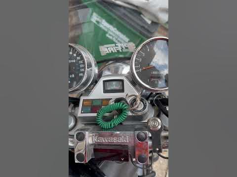

As the title suggests I think the JB has finally flaked out. I haven’t ridden the bike in about a month and In that month it’s gone through a couple of major (45+) temp swings as we had highs in the 60’s and the next day struggled to get to 20. Not to mention to heavy multi day rain events as well. I can’t tell if the bike is waterlogged but an electrical gremlin has surfaced. Instead of writing a multi paragraph post on what I’m experiencing. I’ve just made a couple short vids. Between the two I think it captures all the symptoms.

Check out the battery. It looks like it has a loose connection, or the battery has gone kaput.
I charged the battery and tried starting it again. Still nothing, since it’s dark now I noticed when I turn on the ignition the right side driving light did not come on right away.
Earlier I checked the battery terminals and the frame ground and that all looked good. I manhandled all the wiring and even pulled the connections to the JB and hit them with dielectric grease. The only corroded wired I see is one of the three stator leads, this needs to be fixed but I’m pretty sure it’s not my root cause because if I can’t get the motor to turn there’s no juice flowing there anyway. I noticed whatever is going on is definitely pulling on the battery. This last time I had the onboard voltmeter one and I watched the voltage drop way down and then come back up when I shut the key. Something seems shorted out.

Here’s one more video, the rain stopped so I pulled the seat and hooked up a meter while trying to start it.
What you don’t see is that my jump starter was finally charged and I was able to at least spin the starter, but the jump starter is beeping like crazy and although I can’t find the instruction sheet I’m pretty sure the beeping means “your battery is f&@ked!”
You might be able to find the manual for the jump box online, I do that a lot.
That 12.25v on the meter is a dead battery. Looked like it was plummeting downward.
It was dropping, the wonkiness had me wondering if something was shorted at first, but once I heard the starter engage with jump pack hooked up I felt better. I’d rather replace a battery then chase gremlins.
