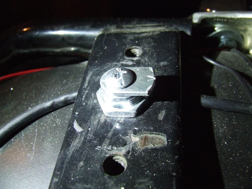

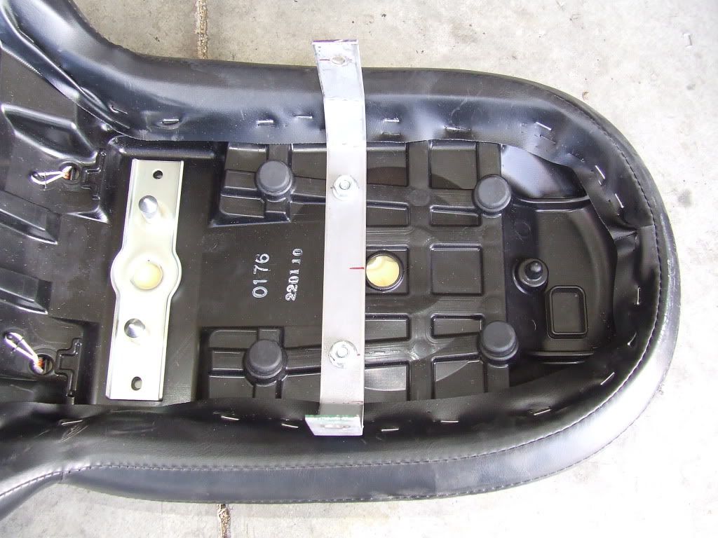

My recent battery problems has highlighted the necessity for a better way to mount my 900 seat. Previously, I had made a bracket that bolted to the underside of the seat, and then bolted to one of the sets of holes that the sissy bars bolted to.
The problem was that if I used regular bolts, I wouldn't be able to get to the battery when needed. So then I used bolts that basically had a wingnut for a head.
That made things a little easier, but then I decided that I wanted to reattach the sissy bars in anticipation of attaching a backrest for my wife. As such, I needed to more permanently affix the sissy bars, which meant that the bracket wasn't going to work anymore.
So here's what I came up with:

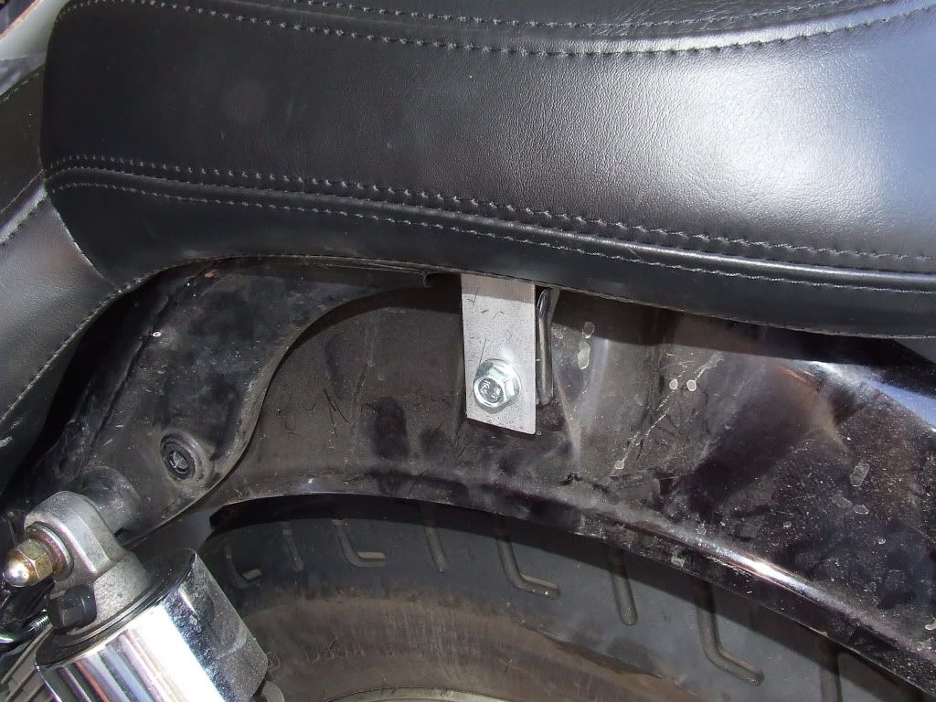

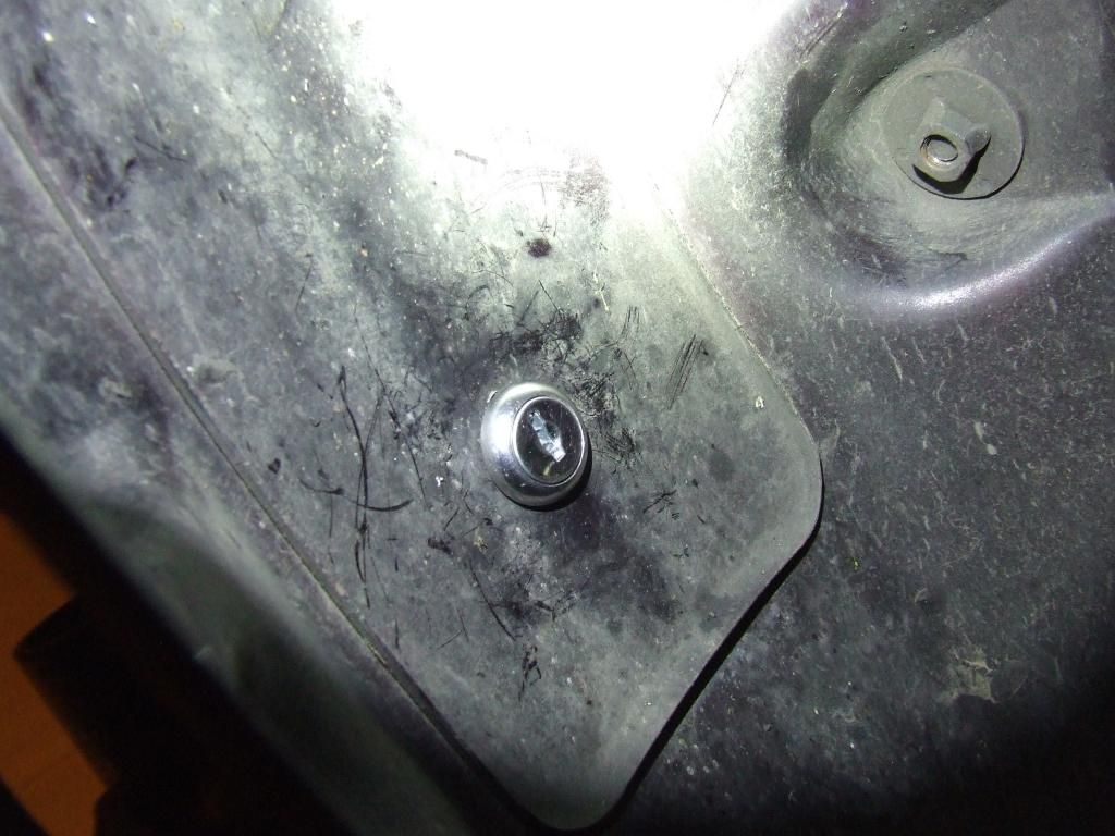

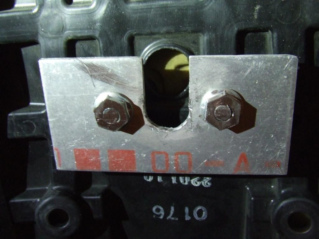

I spotted a desk drawer lock and thought I could make that work. That way it has some security, and the ability to release the seat if necessary. Drilled a hole in the rear fender that lined up with the big hole in the frame above the fender. For the bracket on the underside of the seat, I cut out a U-shaped hole in a piece of metal. This gives the seat side-to-side stability by using the lock as a post, as well as keeping the seat from sliding back by the same principle. Then, of course, the lock bar keeps the seat from being lifted up.
Haven't had a chance to ride test it yet, but so far it seems pretty secure.

Looks cool, but how accessible is that lock with it being directly below the seat?

The lock appears to be under the fender, not the seat.

Yep, just reach up under the fender, find the lock, insert key, turn and remove the seat. I can make a short vid if it's still not clear.

If you're talking about the bar, it's really pretty short, but that was dictated by the location of the bolts that attach the plate to the bottom of the seat pan. I already had that plate with the holes already in it, so I just adapted it to my purpose. If I were starting from scratch, I would instead put 4 bolts at the corners rather than just the two, and that would allow for a longer bar, though really it's not necessary. The seat doesn't move forward, so all it needs to do is keep the seat from lifting up, which it does.
So far the whole thing has held up well. Even took my wife on a shortish 2-up ride, and it was rock solid.
