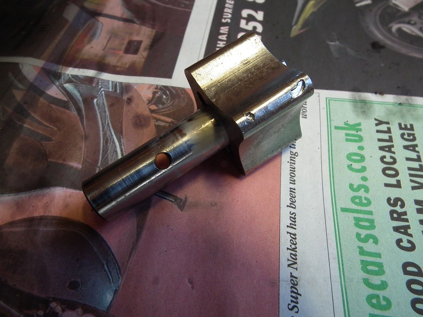

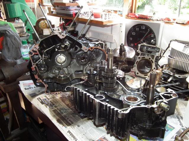

I took the engine out and changed the base gasket, freed the rings, cleaned the carbs, changed the stator and some other bits and pieces. Started her up and she started mixing the coolent with the engine oil. Took the engine out again and stripped it right down as I should have done the first time ! Here are some pictures, including the sorry mess that was the water pump assembly. The debris on the right is the "sealed" bearing as it fell out. You can also see that the mech. seal is broken and the shaft is heavily pitted.
Here are the crankcases

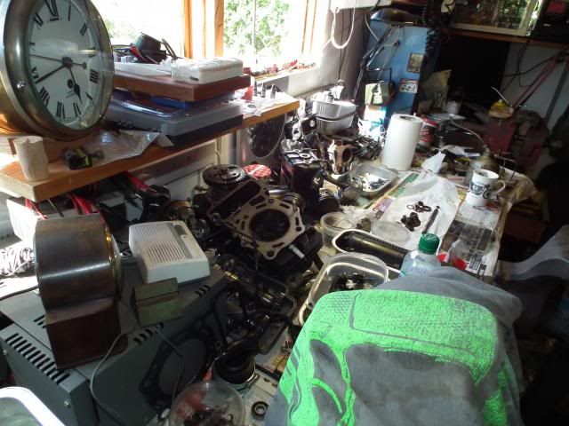

Here is my bench

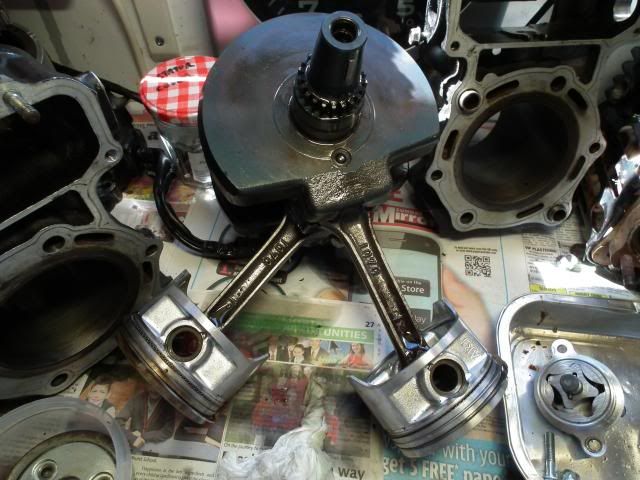

last is the crankshaft assembly, seems to be in good condition.

Super naked
The paper is now soaked in oil and I can't read it. It's a local paper so usually they just go on about "a man lost his donkey yesterday" or "shock horror a woman got her socks wet today" Whatever it was, we will never know. It was on the car sales page if that helps.
