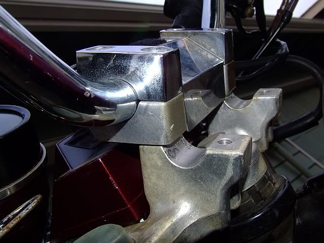

But I think I may have figured it out. I totally forgot that I have an extra triple tree from that crashed bike I bought. I could cut off the bar mounts and install them on top of the ones on my bike. Looks like it might work perfectly. Heading out to the garage to cut them off. I'll update with more in a bit.

Got them cut off with little trouble. Now I just need to level the bottoms out. After that, there's a really good chance I'll be able to bolt them directly on. Just need to find a neighbor with a bench grinder or belt sander.

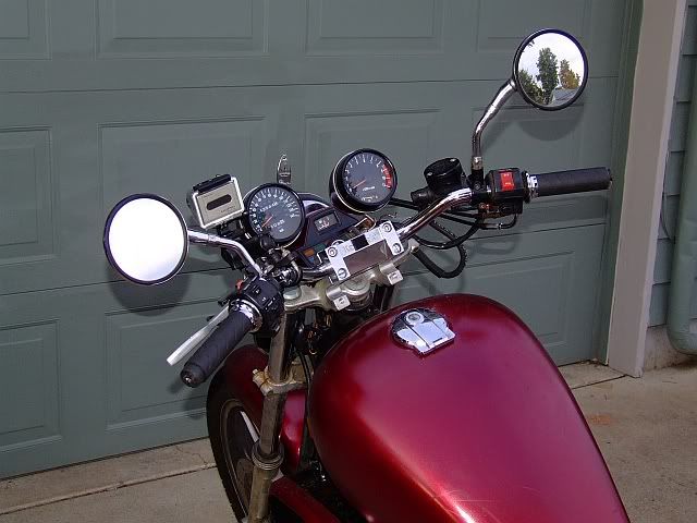

Got it sorted out:
Really like the overall look:

I like that modification and it moves the bars forward by about an inch and a half if I am looking at the pictures right. I have extra long arms and that may be an improvement for my arm comfort. Using the remaining lower/rear threaded holes I would have a nice location for a small rectangular bar and box for the switches I need to mount for my driving lights and switching between my dual headlights. Nice work. Are you going to finish off that open location in any way or leave if for a future project?

If I'm seeing that right, you only have two bolts holding your bars to the bike now?
Seems a bit weak engineering wise.
Yeah, but there's no way around that that I can think of. I've seen some risers that are a similar design (just a single bolt), so I think it'll work.
I would like slightly longer thru bolts, so I have to try to track some down.
