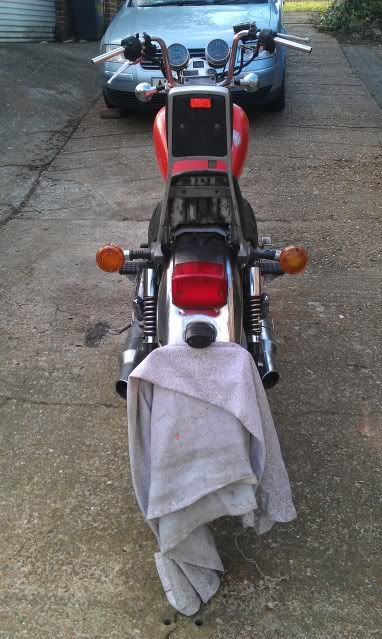

I won an 86 VN750 that hasn't been run since 2008 and had been stripped.Well went to pick it up yesterday. I must say I was a bit disappointed when I saw it. The front discs are knackered, the tank has a lot of filler on it and there seemed to be a lot of bits missing. Most of them, but not all, were in two plastic boxes! Anyway a deal is a deal , so I strapped it onto my trailer and got home about 1700. Did some work on it today. Eventually found a 18mm socket to remove the plugs, all 4 of them, squirted some WD40 in the combustion chambers and put the plugs back in. The headers had nothing holding them onto the heads and I thought I would need new ones, but today I found the split collars and rusty domed nuts to hold them in. Limitting myself to just doing work to start the engine, so I tried to refit the battery box that carries the solenoid, reg/rec, and coils, but it won't go under the seat until I remove the rear wheel. will de-rust and paint it tomorrow and refit it on Tuesday.
Some pics;

It dont look to bad judging by the photo's !. Hopefully you will find the engine is OK,that will be a big relief for you. Once your happy with that,,then it looks like it could be an interesting project putting it on the road again. Pity the disks are goosed,but try Ebay for used ones. Like i say it looks (from here) as if it will turn out good.

Don't care what anyone says. Love the chrome fenders......
post #6 of 48 (permalink) Old 03-11-2012, 08:18 PM
rev it up's Avatar
Location: County Durham. United Kingdom (england)
Posts: 133
And the headlight visor,,eh KM. wink wink...lol.
