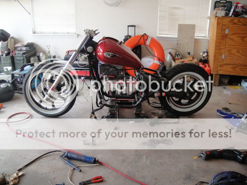

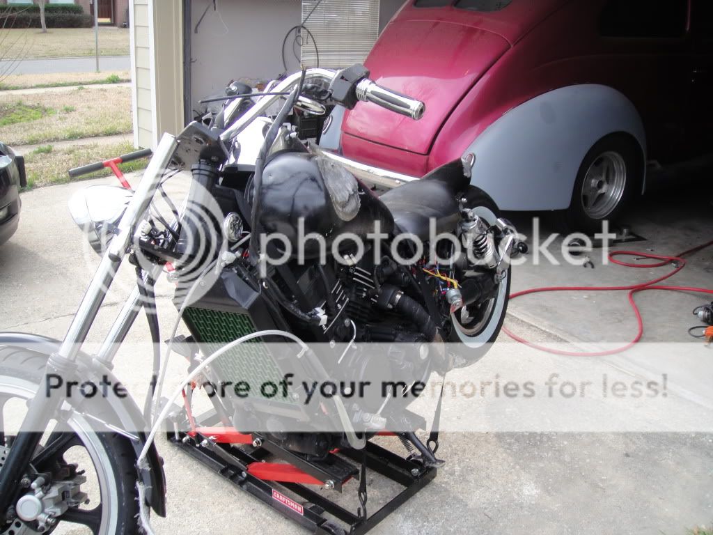

bobber build, wrecked my chopper
A while back I totaled my chopper :. so, since i have sold the idea to my wife, I am going to build a bobber out of my wreckage. I purchased a used front end and vn800 gas tank off ebay for about 80 dollars. today i purchase new hand controls, grips and bsa drag bars. the bike will be a rigid with a springer saddle.

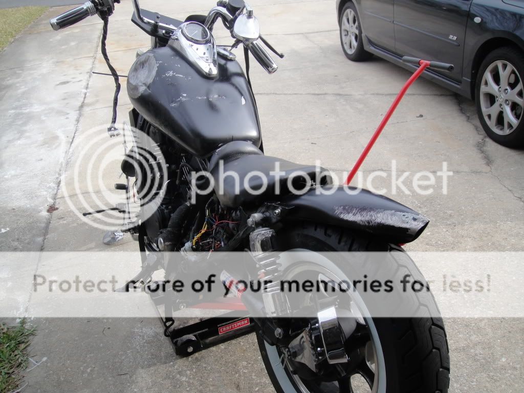

pics of wrecked bike
here is what is left of my bike. it is not too bad.

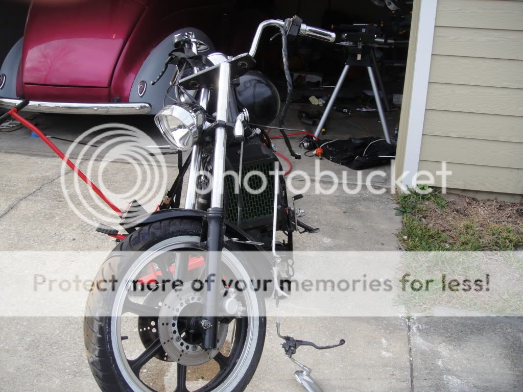

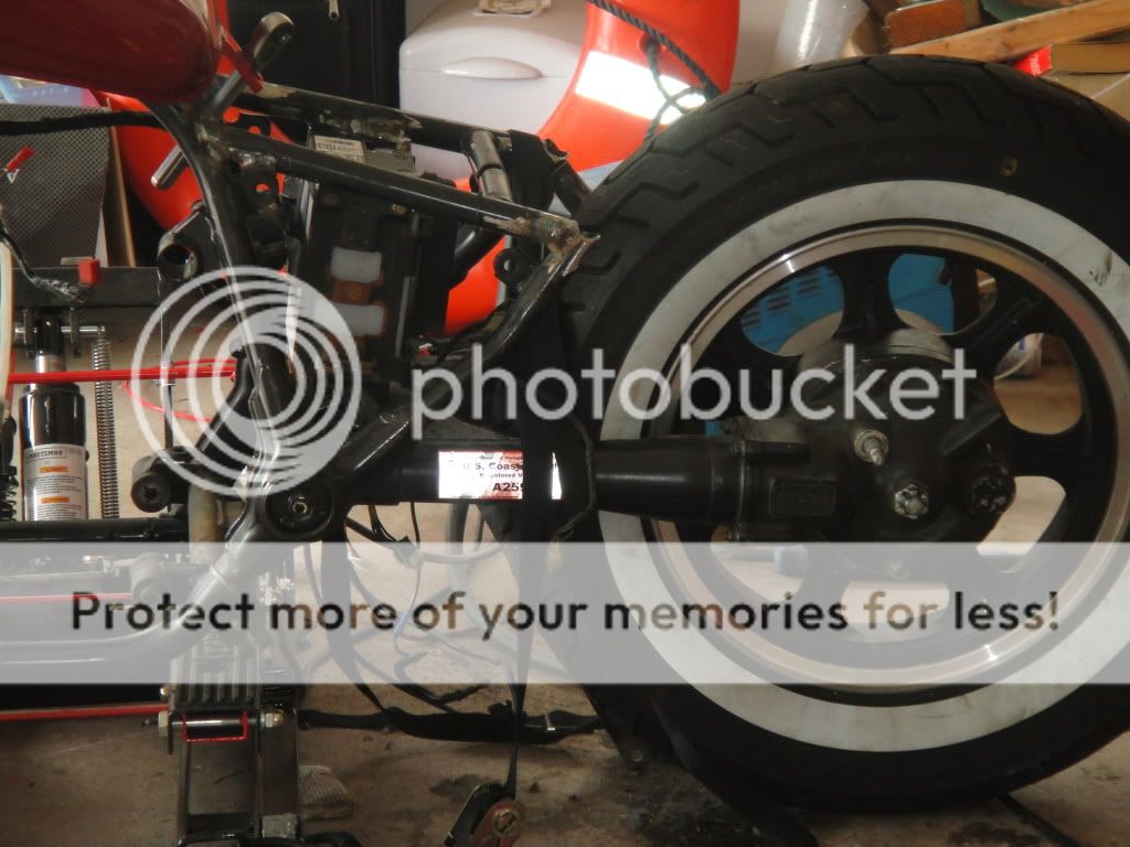

started on modding frame
I have cut off the seat rails and parralleled it with the top of the side covers. I decided to to do this because the shock mount were damaged from the wreck and I am going to use 9" swedged radious rods to make my "stays" in bycycle terms lol. Alot of people say the drag bars tend to get into the tank. later on I will get into how I will get around it when the bars arrive.

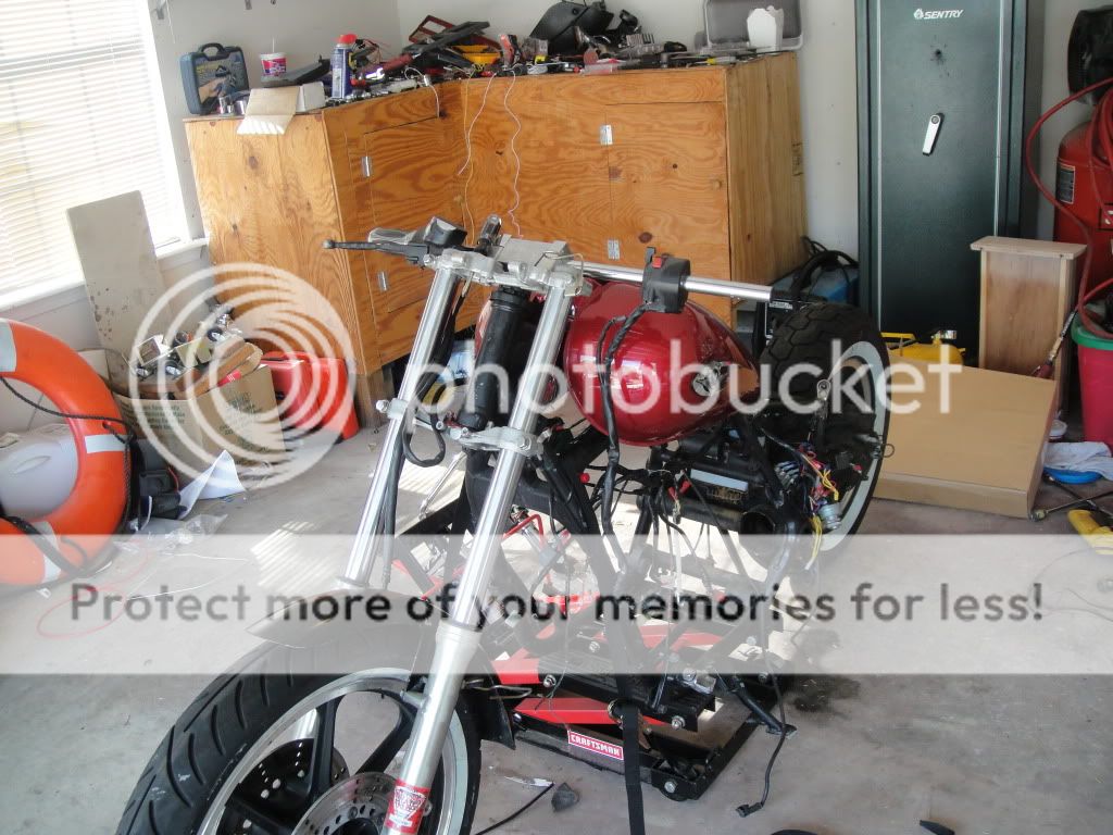

I got my new handle bars and left controls in today. I think our bikes look great with drag bars. I should get my seat by the end of this week. Here are the pics. The VN800 mastercyclinder helps alot with clearance issues.
