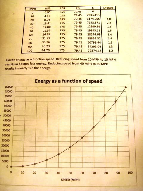

Energy as a Function of Speed
I was reading that cutting your speed by only 10 MPH reduced the amount of energy released in a crash greatly. Since kinetic energy is proportional to the velocity squared, it makes sense. (KE=1/2*M*V^2) So I figured I would make an Excel spreadsheet and see for myself........

It's an even bigger deal than that. Stopping distance is ALSO affected as a second-order function of the speed at which you start...Every MPH you slow down, it requires less distance to slow the next MPH.
In the distance it takes to slow from 100 MPH to 95 MPH, a vehicle traveling 31 MPH could be stopped.
In the distance it takes to slow from 100 MPH to 90 MPH, a vehicle traveling 43 MPH could be stopped.
In the distance it takes to slow from 100 MPH to 70 MPH, a vehicle traveling 71 MPH could be stopped.
It works the same way at city speeds, too:
In the distance it takes to slow from 40 MPH to 30 MPH, a vehicle traveling 26 MPH could be stopped.
How is distance a second order function of speed? I think you mean acceleration.......
These numbers look right....( I'm curious where you got them?) mathmatically anyway. ( V(stop)=sqrt(Vi^2-Vf^2) ) But this assumes the same acceleration, and that just ain't gonna happen ( reaction time distance, not to mention the friction coefficient is different at different speeds, and so on, blah, blah...... ) Of course your point is right on..... Stopping distance is increases with speed, hence the two second rule for minimum following distance. ( as per MSF guidelines)

Sorry, but when I see numbers I have to figure out where they came from......
Below is a photo of how I checked out ImBoring's data. It was a fun math exercise

I guess I don't need to show the second-order nature of stopping distance vs. initial velocity any more, since you just did it, complete with some underlying calculus...Nice.
I find that very poignant. In the worst-case, no-time-to-react scenario, the energy released in a crash decays with the square of a reduction in speed, which was how you started the thread.
However, if you have time to react, the benefit of the slower starting speed is also seen in the amount of speed you can scrub off, so the speed at impact (If any impact even still occurs) is reduced by MORE than the initial reduction of speed at the start of the emergency braking event, and it is that speed at impact which is squared to determine the proportionality of the energy released, so you see what might be called a snowball effect.
