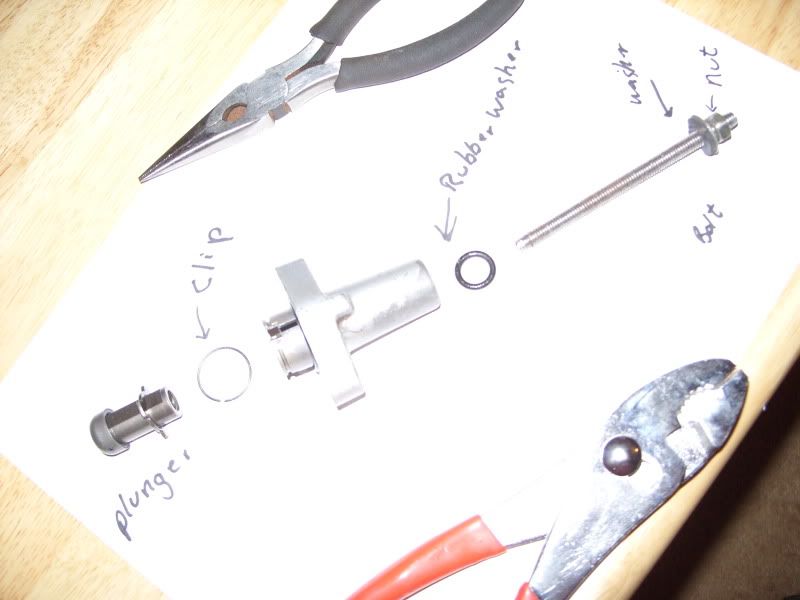

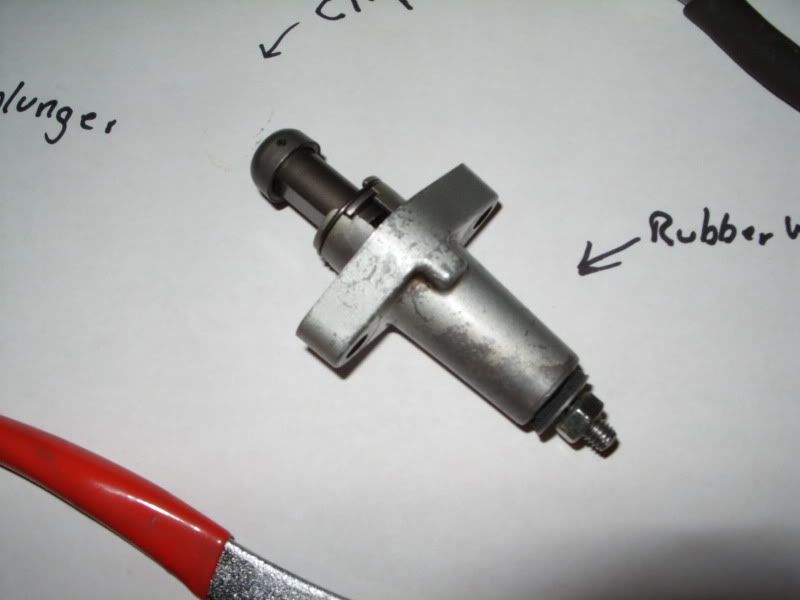

I bought an all thread 6mm X 1.0. Took the guts out of the acct, replaced the plunger and clip. Got a washer from metal self tap screw for tin building. Cut about 3.5 in. of all thread, screwd it into the acct and used a nut to lock it down after adjusting it.
I will mod another one with pics and post. I will try and get it done tomorrow.
If you got $$$ you can buy them ready to go.
Oh yes they are called mcct's (manual cam chain adjusters)
Pic of parts used.
pic of assembled unit.

Tried the Grambo trick and it worked!!!!! After two years of listening to the clack clack clack, it's gone. Many thanks to all!!!!!! Now off to the rest of the board.
