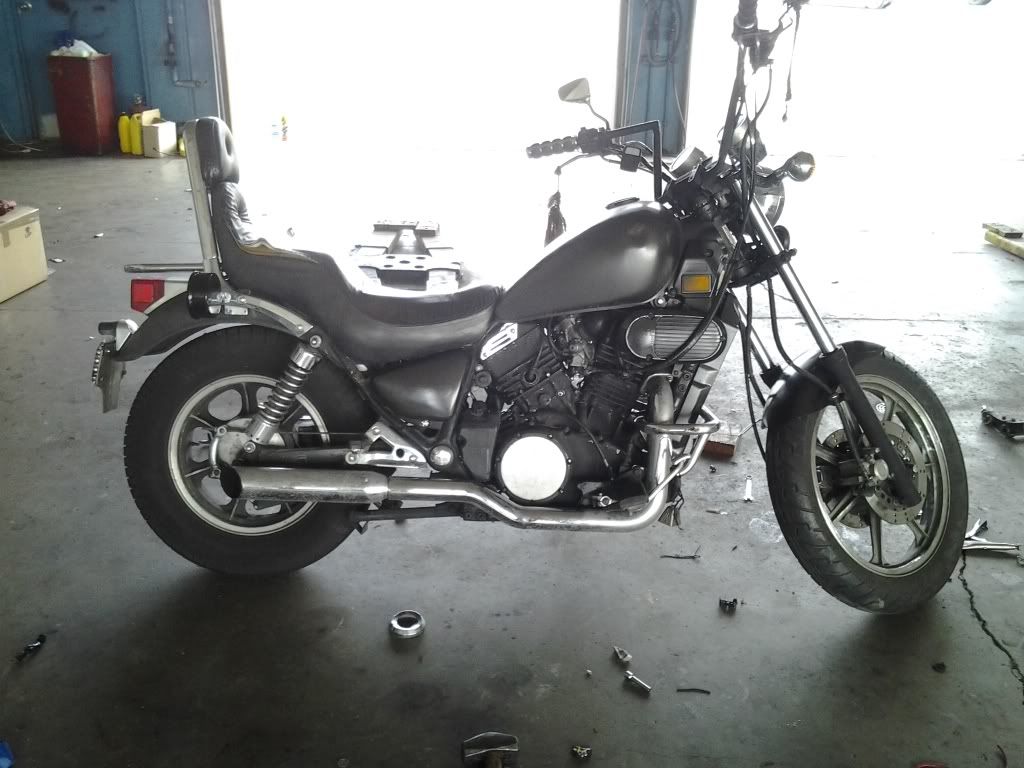

I have them, here is a pic..
And a video of the sound of my bike: https://www.youtube.com/watch?v=unwvRpOF_94
You will not need to rejet. You may want to perform an earshave for various other reasons (search on here). No performance boost from just the exhaust.

All the images I see on websites have been for the wrap around pipes. Is that just them reusing an image? I see yours are not. Will I have to tell them when I order?

No rejet if you just change the exhaust.
That is a stock image online. The cruzers for the vn750 are one pipe per side.
They have a great sound but don't really add any performance that you'd notice.
