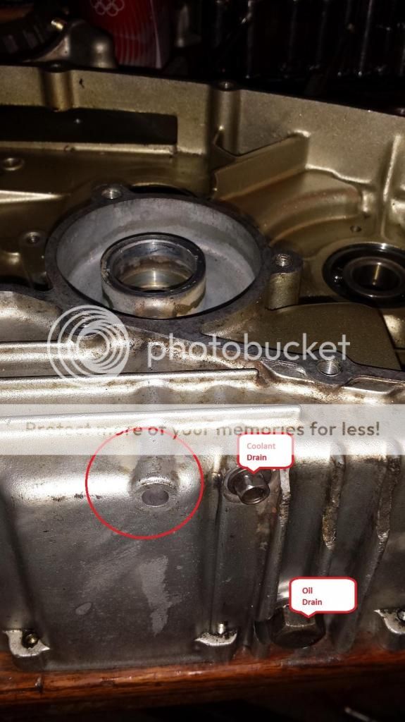

Can anyone tell me if there is anything supposed to be plugging this hole? Or something attached to it?
I don't recall taking any bolts out from here, never-mind that there aren't even any threads to accept a bolt in the first place.
The channel leads straight into the center hub where the bearings sit. Looks like it would come out between the front of the bearing and the back of the mechanical seal.
I'm thinking that if the Oil seal behind the inner bearing, and the mechanical seal are doing their jobs, no fluid should be getting in this area.
the thing was completely blocked up with dirt and grit.

hi, there is no plug or bolt there, mine has an empty hole like yours.

that is a weep hole in case your mechanical seal goes bad.

Thanks guys, that's kinda what I was thinking, but wanted to be 100% sure.

what ever you do if it ever starts leaking do not stick a dowl rod in it like some idiot did on my dads gl1200 cause it will just push the coolant into the oil instead of out on the ground

My .gl1000 is leaking out the weep hole.gotta do waterpump.haven't ridden her in 2 years cause they are fun to do a waterpump on.
With as much dirt that I pulled out of that weep hole, it may as well have been plugged up with a dowel rod...
