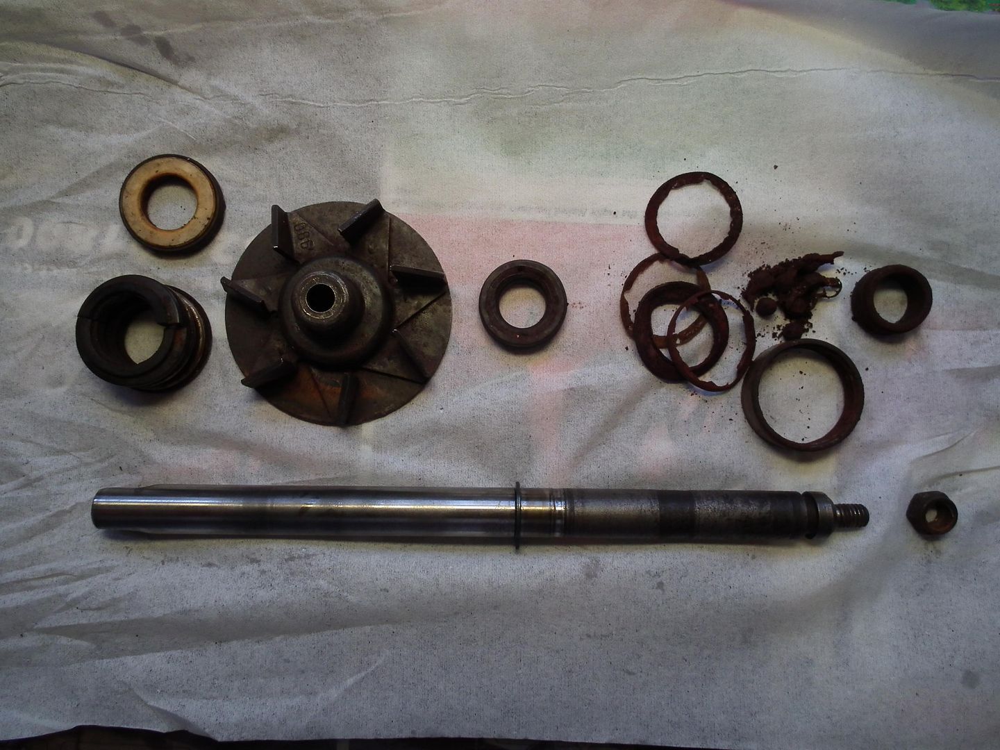

My VN 700 had stood for years in a back garden and the water pump seal and outer bearing were both destroyed by corrosion. It produced the effects you have. You can remove the right hand side cover. This allows you to remove the pump impeller so you can inspect the mechanical seal. To remove this seal you will effectively destroy it, but you can then see the first sealed bearing, mine had lost its rubber sealing and was a sorry rusty mess (my weep hole was blocked). If the pump is the source of your problem this bearing will have lost it's rubber seals and will be passing coolant through into the crankcase. To replace this bearing requires a crankcase split as it needs to be drifted out from the inside. It does give you the best chance of removing all the "mayo" from inside. If you remove the impeller, and the mechanical seal looks good, then most likely the pump is not the problem. Here is a picture of my old pump assy. You can see the broken mech. seal and what remained of the "sealed" bearing, the shaft was heavily corroded. There is a small o-ring in the inside of the impeller which was missing on mine, also the retaining nut was stripped (It is supposed to be a "use once and discard item).

Thanks everyone for you input. Everything is pointing to a bad impeller seal. I will pull it apart and order the parts.
Is the nut something special I should order too or can I pick up a lock nut locally?
if the bearings are starting to go the bike will be sold. I am not pulling that motor for a
3rd time in less than a year.
I assume the O-ring goes into the groove on the shaft? Mine had some rubber in there but not much of an O-ring shape.

The nut is a special locking nut, and not that expensive if I remember. Yes, the o-ring goes in the groove of the shaft and seals the shaft/impeller junction.
