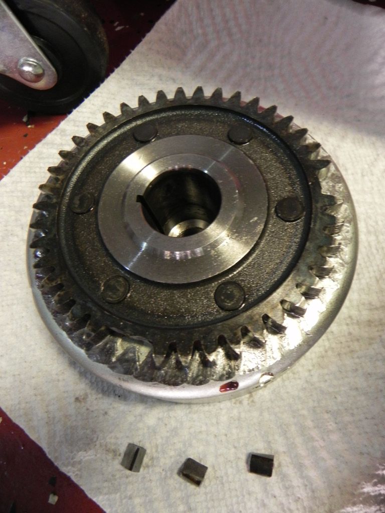

OK been having some strange noises coming from the front part of the crankcase, so I decided to break her down this weekend. I was afraid it might be the front connecting rod bearing. However when I got to taking the flywheel cover off I found three pieces of gear tooth sitting in there, and after pulling the rotor discovered it was from the back gear on the rotor. It appears so far that I was really lucky and the broken teeth did not find their way into the rest of the engine, though I am gonna pull the heads while it's out and waiting for parts just for some inspecting/carbon cleaning. What I would like to know is what could possibly cause this? Has anyone else seen this before? I see no other signs of damage and no marks on the damper gear that look like it may have been aligned wrong.

YIKES! Never seen anything like that on a bike. I have seen teeth sheered off by the starter on other vehicles I've owned. By the looks of things, it would have taken some serious force to break those teeth off like that!
Good luck!
EDIT: Look at the worn areas of the teeth. Looks like close to half were rubbing while the other half is clean. Also look at the length of the teeth. Not all are the same length. Possible the rotor is warped and those teeth were the weakest link or the shaft it mounts to is out of round? *scratches head*

Look at the edge all around it, it's worn too. Very strange.

Yeah the more I look at it I think I got an unlucky buy from ebay. Couple months ago I replaced my original rotor because it was gouged from a fried stator. Looking at my balancer gear there are no marks at all that line up with the worn areas on the rotor gear, so I have to assume it came like that and I just didn't notice, maybe the teeth were already cracked/worn when I installed it. Well I'm just glad nothing else seems damaged.

Looking at the damage....Id say it was an improper install, and a wobble/wear caused it....I dont think the cog was seated properly from the get-go....
But thats wobble wear fer sure.....

I'm with ya Wolfie, but I'm also sticking with my theory that I got it already worn because I just can't see how it could end up like that from my install if my balancer gear is pristine.
