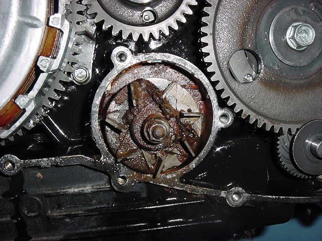

post #8 of 16 (permalink) Old 03-26-2007, 01:51 PM Thread Starter
Join Date: Oct 2006
Posts: 115
next dilemma I see is.. there are 2 dif part #'s. ahh I see now on kaw site the 1052 is superceded by the 1057.
Ok tore it down last night.
Followed the manual mostly
Pulled right exhaust cover, unplugged brake switch, unbolted ear, unbolted radiator cover, removed lower radiator hose, and 1 mounting bolt, pulled the exhaust out and swiveled it down to floor, unbolted the subframe-6bolts, Presto ready for removal. So it looks like prior to me getting it the bike might have sat for a bit.
http://i125.photobucket.com/albums/p...n/DSC00079.jpg
Here are the photos
http://s125.photobucket.com/albums/p56/bwife1/vulcan/
I am glad I pulled this apart to find this!!
Prior to removal
http://i125.photobucket.com/albums/p...n/DSC00089.jpg
After removal
http://i125.photobucket.com/albums/p...n/DSC00086.jpg
Here is what the mechanical seal looks like.

post #10 of 16 (permalink) Old 03-29-2007, 04:29 AM
and the Adventure Cycle
hyperbuzzin's Avatar
Location: Western PA
Posts: 6,138
Looks to be a good thing you got in there when ya did.
Hmm, maybe I'd better check what my waterpump looks like while I'm changing my stator !!
Great pics
