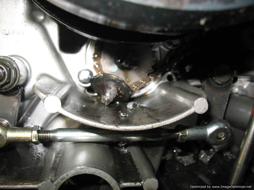

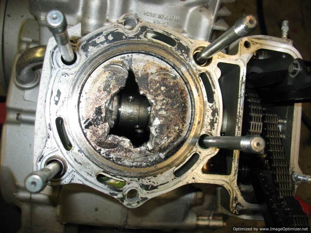

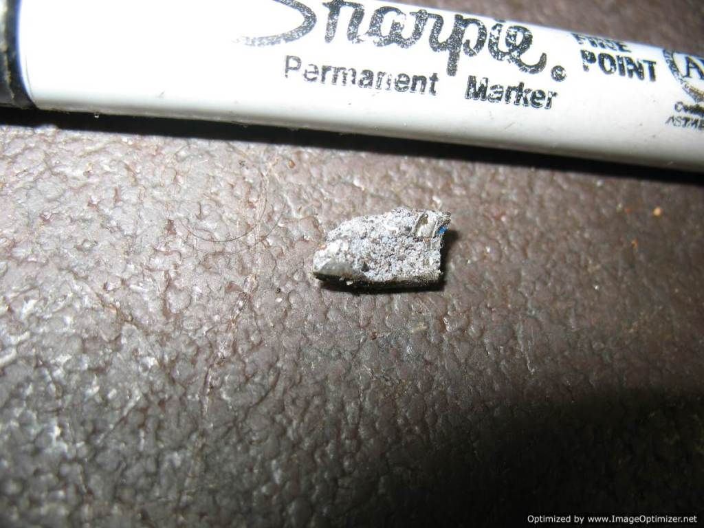

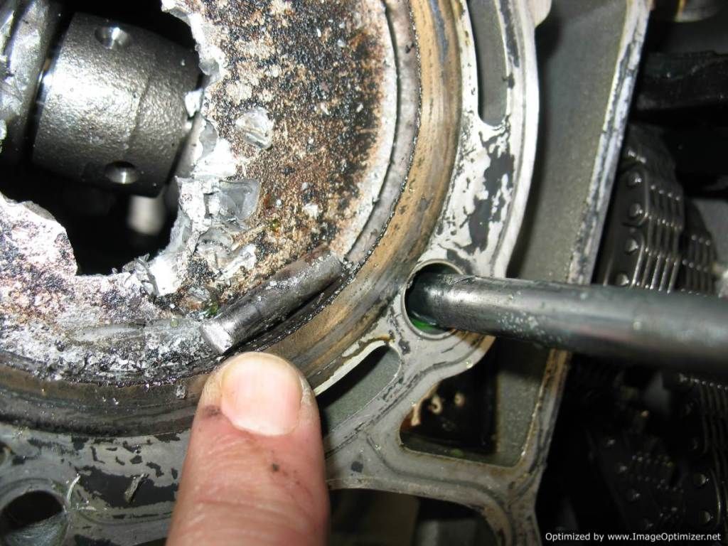

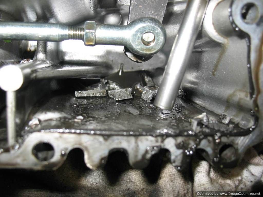

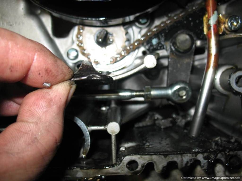

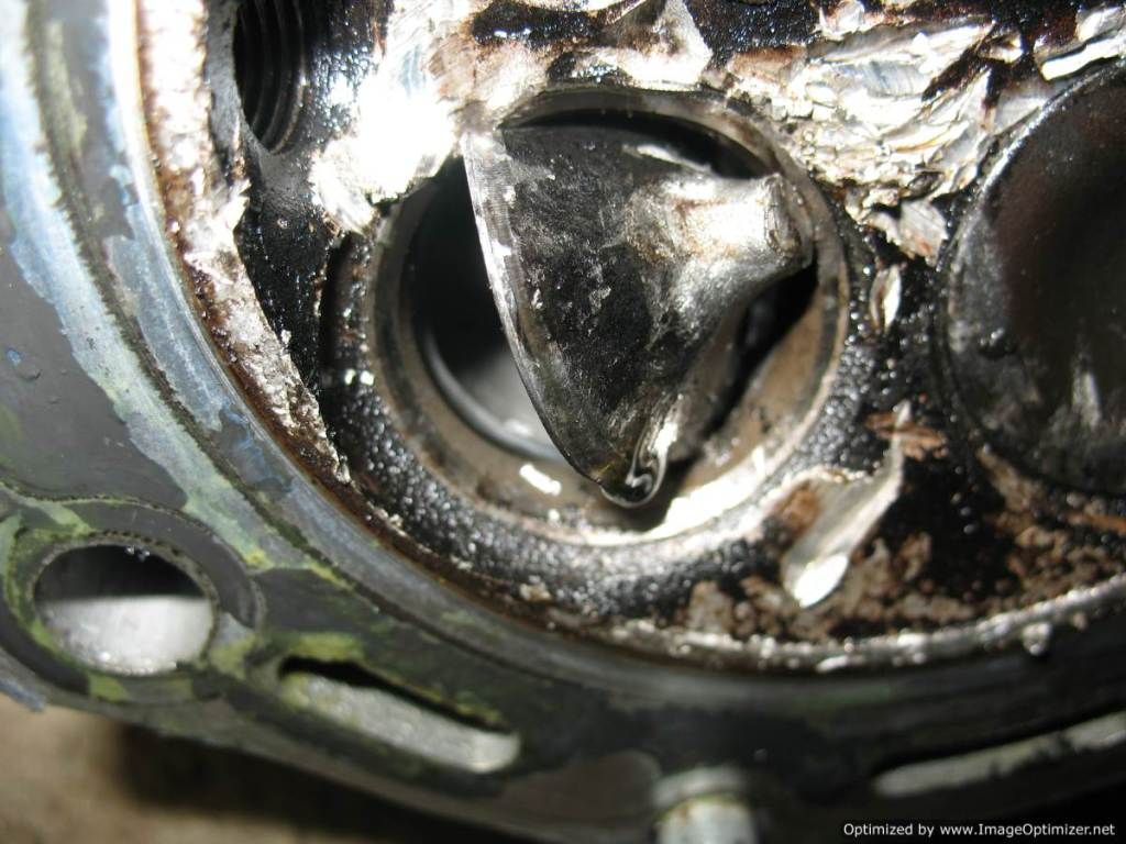

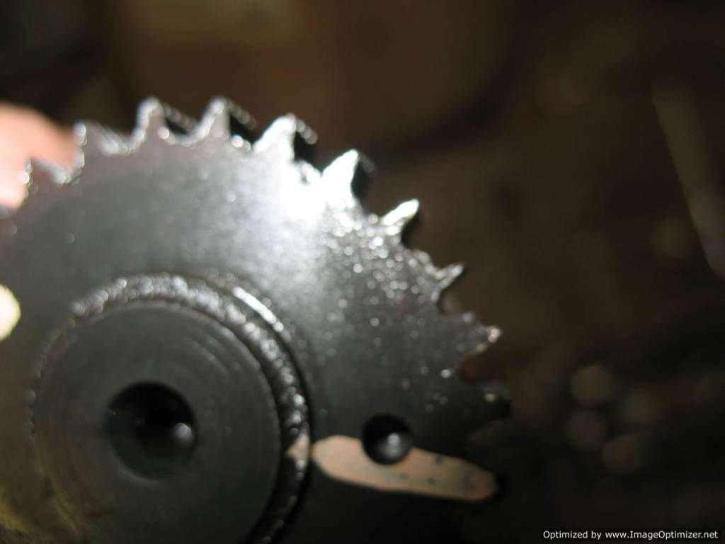

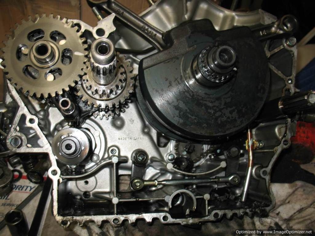

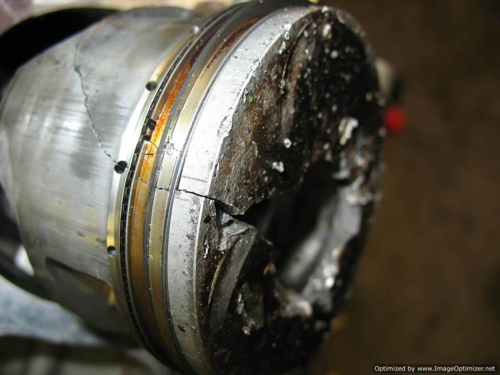

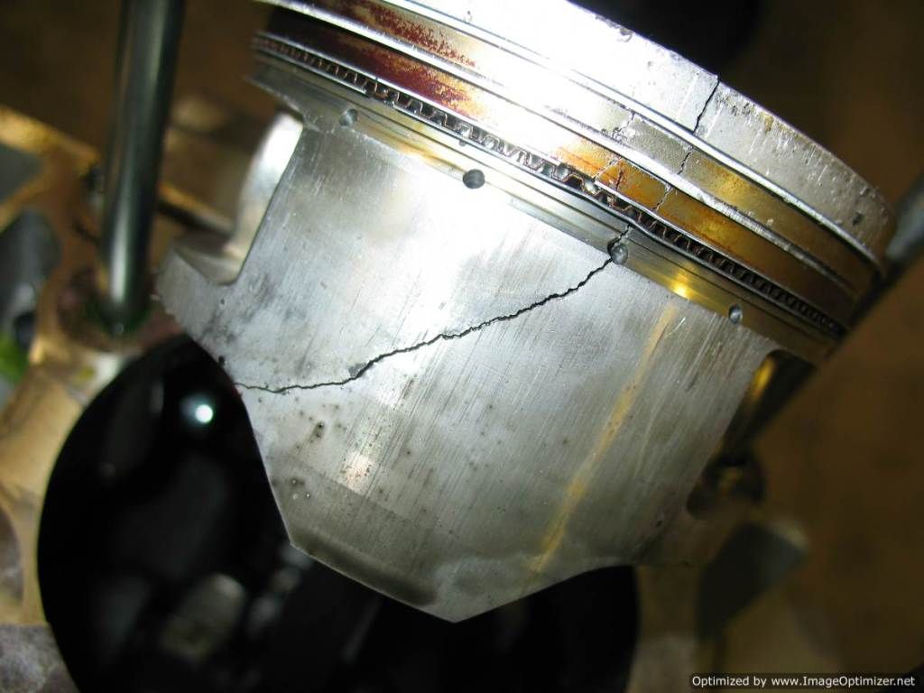

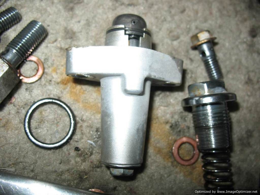

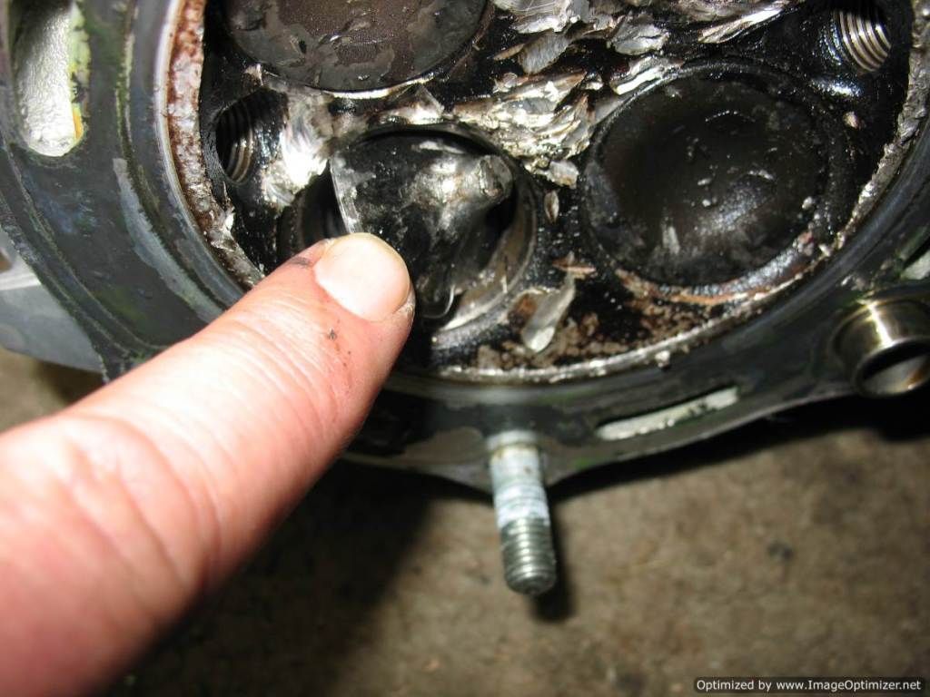

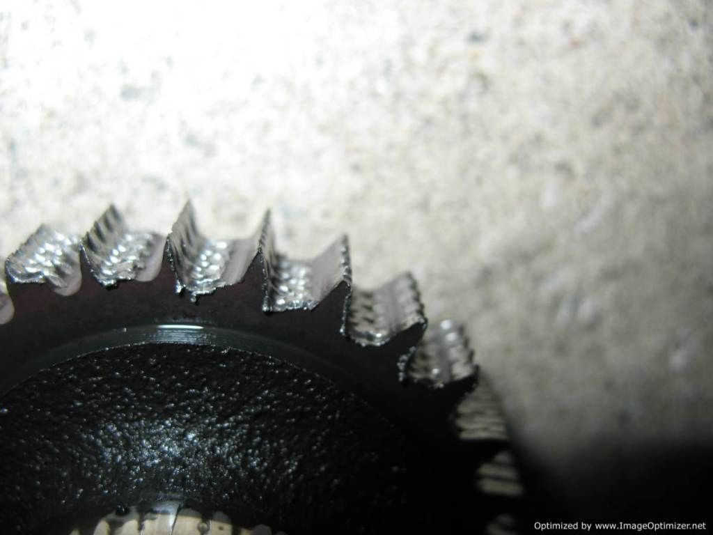

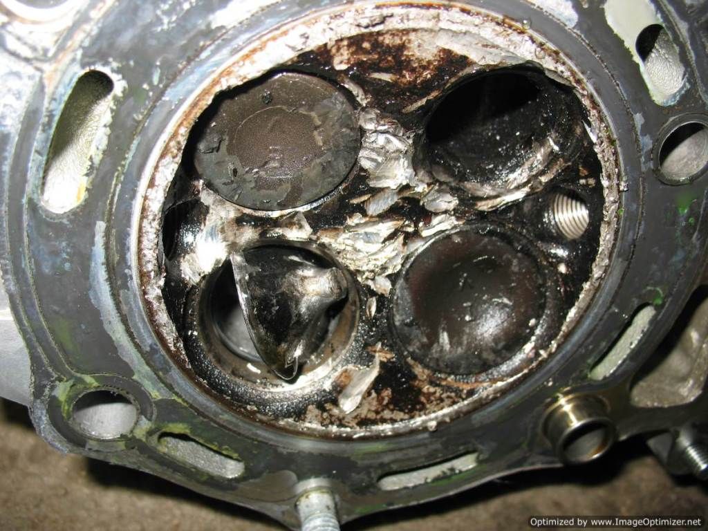

here is a vulcan motor i tore down last winter. it is a 2002 model with 12k miles. the p/o said it died with no bad noise (yeah right!). all you new riders, find out what an mcct is and why it replaces the acct (tensioner). and all you guys that talk about acct conversions so much, here are pics and not words. the p/o lost $2000 or more when i bought this from him, all because he ignored the grinding noises. look at the cam teeth, and the valve that was sucked all the way to the bottom of the case. this motor was well beyond reasonable repair, it just would not have been cost effective. this was the front jug. and with only 12k miles, what a shame. the toc mcct's would have cost $100. to repair this professionally would be several thousand dollars. i am going to be putting the toc's on my 88 vn750 soon, it is just beginning to clatter a bit. enjoy, and be happy it ain't YOUR bike!

first pic, metal in the head pipe. collapsed acct front jug. lots of metal in manifold. hole and crack in piston, mashed valves into head. sucked a valve deep. the cam teeth kill me, how the [email protected] did you think that motor sounded normal??
anyone heard my stupid squirrel theory???

Just a quick thing on personal experience, I bought the TOC ACCT rebuild kit when I got the bike 2 years ago. Put the front cylinder acct spring on, put it on the bike without the ACCT cap bolt, started the bike and all was great. Super quite. put the cap bolt on and started getting a very light raddle. backed off the bolt, quite. The cap bolt was bottoming out on the acct adjustment bolt and the innerds being left hand thread and the cap bolt being right hand thread was causing it to release tention when tightening the cap bolt and it bottoming out. Wonder if this may be a common problem that caused the acct's to not be able to add tention to the chain because of the cap bolt wedge again the adjustment internals.

the p/o bought a new battery and spark plugs thinking that was the problem! he actually said "it idles ok but won't rev up"... the new plug electrode was immediately mashed shut... i picked her up for $500 on cl, he was asking $1000 and trying to make like it was a minor problem! yeah i can't even imagine how horrible the noise must have been with the sprocket teeth being ground off, let alone knocking a couple valves thru the piston cap. i have blown a couple motors in my days, yeah you know when it happens what it is! makes a pretty gruesome sound... plus i imagine if it jumped a tooth here and a tooth there it was pretty much running on one cylinder there at the end of its poor life.
