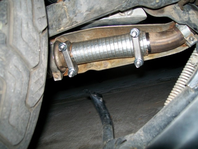

Well since I had my buddies VN750 to do the stator replacement, he wanted it painted and something done with the exhaust...... I just got the paint work done and came out awesome.... he wanted Black and that is what he got.... Well I looked at scoot works degoat and it comes out over 80 buck shipped, so I decided to do my own version of a de-goat.....He still has the stock air cleaners so not to worried about jetting, but will keep an eye on plugs down the road..........Also i bet miles pe gallon gonna go up ditching 20 pounds of Goat Belly! That thing is heavy, i was amazed!
I m sorry i did not take many pics, guess i just wanted to get it done But can tell you what I used and how much.........
Universal 1" 3/4 ID x 18 " flexible tail pipe $5.99 Orielly Auto parts
Part Number: 540175
http://www.oreillyauto.com/site/c/de...keyword=540175
4 x Automotive exhaust clamps 1" 3/4
Part Number: 517134
http://www.oreillyauto.com/site/c/de...0082&ppt=C0022
Well first thing I did was remove the goat belly and shields and rear muffles on each side.........
I removed the exhaust flange seals from the mufflers, I then ground down the single rubber mounting washers that the pass through the rubber that mount the mufflers to the foot peg bracket, about 1/16 off each of the inner and outer metal portion so when i hang the muffler and tighten it up it wont flop around and will stay put while you measure and mock up the new pipe before you cut it........
I then loosened up each header header pipe so it would move slightly.....
I started on the right side.

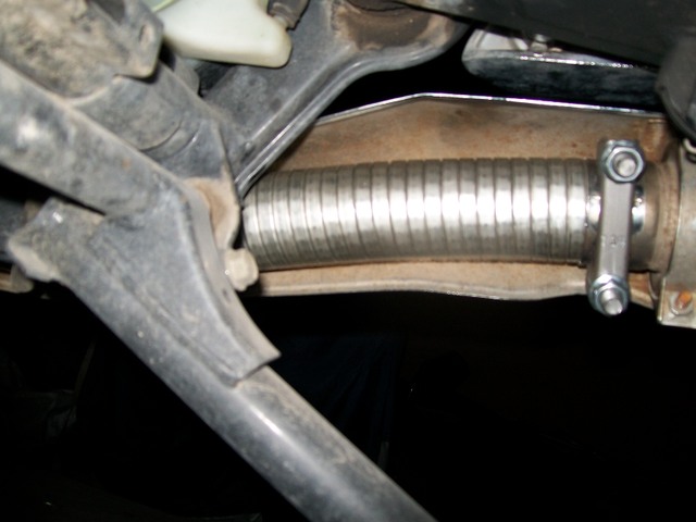

I hung the right muffler and tightened up and alined where I thought it should be....then i took the flex pipe and bent it and layed it out side the header and muffler to get an idea where to cut...one end slides over the header pipe about 2 inches and the other end will slide into the muffler.... I marked with painters tape where to cut around the flex pipe.....
I then cut it..... Then I took off the muffler and slid the cut flex pipe all the way in and then slid the other end over the header pipe and mouted the muffler and snuggged her up....then installed a new muffler clamp on each end..... I moved the pipe around untill happy with alignemnt...I them tigtned the front clamp down on the header... i got it tight and mashed.... Then I removed the clamp and installed an OEM band clamp i had removed off the bike.....I tightned her up and that part is good.... i had to use one OEM band clamp on that the right header pipe as the automotive clamps hit the shield and did not hwant to notch out the shield...but you can decide if you want to if you like the idea of the stout automotive clamp.....
Then I left the rear clamp on the muffle loos and installed the heat shield, lined it all up and tightned the heat shiel to the exhaust....that is what lines it all up and keeps it aligned as you tighten down the clamp on the muffler....
After that was done I went ahead and tightened up the clamp on the muffler....... Right side is done
Left is the same concept....I got lucky and the new pipe I had cut from the other side was perfect for the left side....
So use the least amount of pipe on the right side and you will have enough for the left side out of 18 inches of flex pipe......
I also completely gutted the stock mufflers....that was a job in itself.....

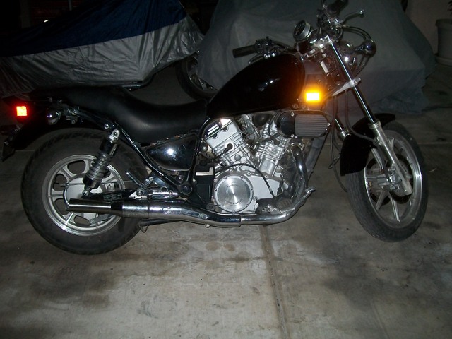

This degoat i used shoud be perfect with mufflers that are gutted or hollow with no back pressure...... the bike sounds awesome and has that v-twin sound at idle, also the exhaust is stable and not loose feeling after all together which is a big plus................
I also added stainless tips that where a perfect fit for on the OEM mufflers, they slid all the way on and covered up the holes i had to drill to get the baffles out...... they where old westinghouse solar yard lights that died years ago but i kept the stainless tubing from them....I knew one day they might come in handy!
It came out less then 20 bucks for my version of the De-goat!

Nice job! Looks good. I thought about going with flex pipe on mine. How does the center stand work? Did you have to fab a bracket for the center stand to rest against?

Center stand seems to work exactly how it did before the mod..... The part that you use your foot on rests against the left muffler in the cut out that is made for it, I didn't notice if it rested on the goats belly before I took it apart, but i don't see any problem with it sitting on the muffler in the cut out how it does now ...I could wrap the part of the center stand that rests against the muffler with silicone tube or a piece of heater hose if it rattles going down the road, but I rode it and didn't notice any rattles from the center stand, couldn't hear to much but the loud exhaust note from gutted exhaust

I used the flex pipe on mine, too. The center stand does contact the left pipe, so I siliconed a bit of rubber hose split lengthwise to keep it from rattling when I hit rough road. I also used the stock exhaust clamps with some scrap steel (18 gauge, I think) for shims to make sure it tightened down well. Only cost I had in was for the flex tubing, though I bought a roll of header wrap and did that while it was torn apart.

Thanks for the pics and instructions Rags. I bought my stuff from O'Reilly's, and cost me about $19, and took about 2 hours to remove the goat's belly and install the straight pipe. Runs great and sounds even better.
