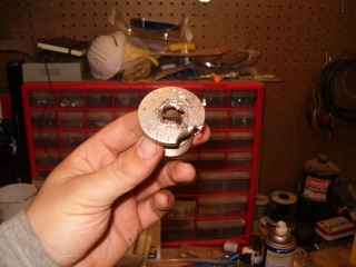

Well just like bunky I fell victim to the drain plug issue. It was time to change the oil on my wife's bike. I had recently purchased it but hadn't yet made time to perform the first round of maintenance. Long story short, her drain plug was stuck tight, properly sized wrench and some taps later...I rounded it off.
Vice grips...oblonged it.
Pipe wrench...mauled it.
Drill and screw extractors...bored a fat hole.
Desperation and a cold chisel...succces!!!
I made two notches radially and was rewarded with a nice radial crack. Immediately after it cracked it turned smoothly like nothing had happened. Here's a few pics of the little cuss:
I'm just glad I had the foresight to stop what I was doing once I rounded it off until I got a new part from ronayers.
