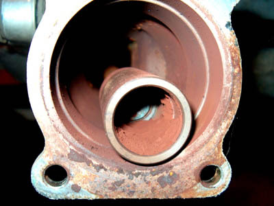

Here's some examples of stripped coupler splines:

Here is the condition of my coupler. I didnt think it really looked to be in that bad of shape?
Looks like the first 1/4" or so is ground off. Hard to see though.
