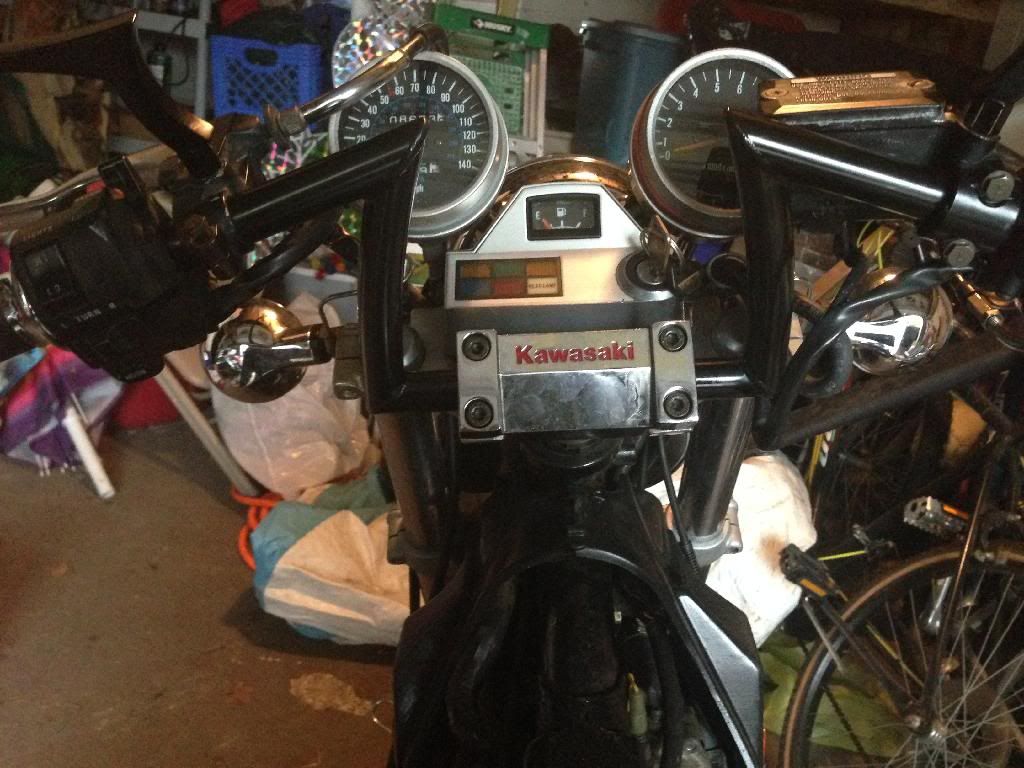

The torx bit worked beautifully. So I get everything back on and this is the problem now.
The clutch cable is so tight and the master cylinder is blocking the rpm gauge. How am I to solve this? Would I have to order risers?
