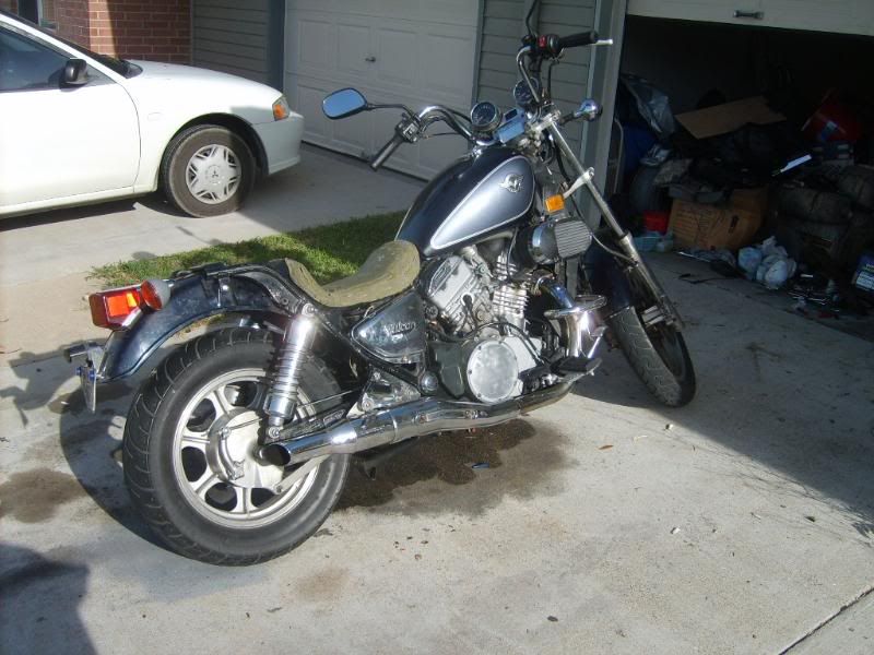

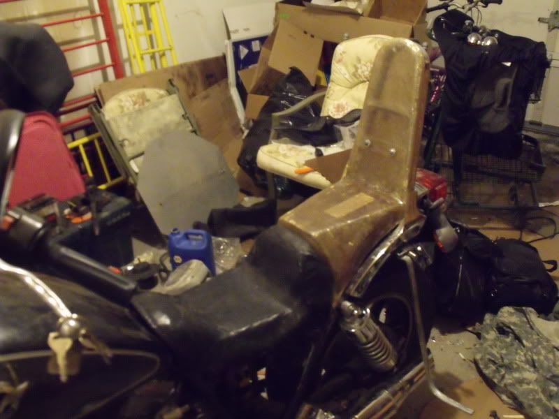

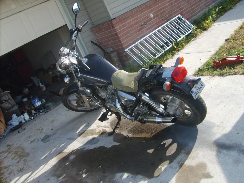

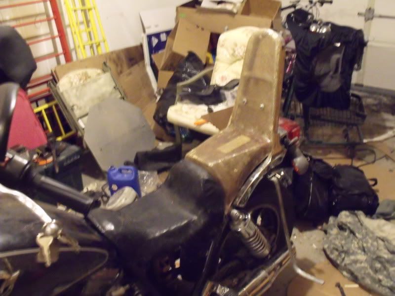

I have exactly what you are talking about.
I used Jeffery Phipps Seat Pan tutorial to make my solo Seat Pan. I had very little experience using fiberglass before taking on this project, but found it to be very easy, just fallow the instructions on the can of resin, and have all your cloth and matting precut and mapped out where you are going to place it for each layer.
This is how the Solo Seat Pan turned out.

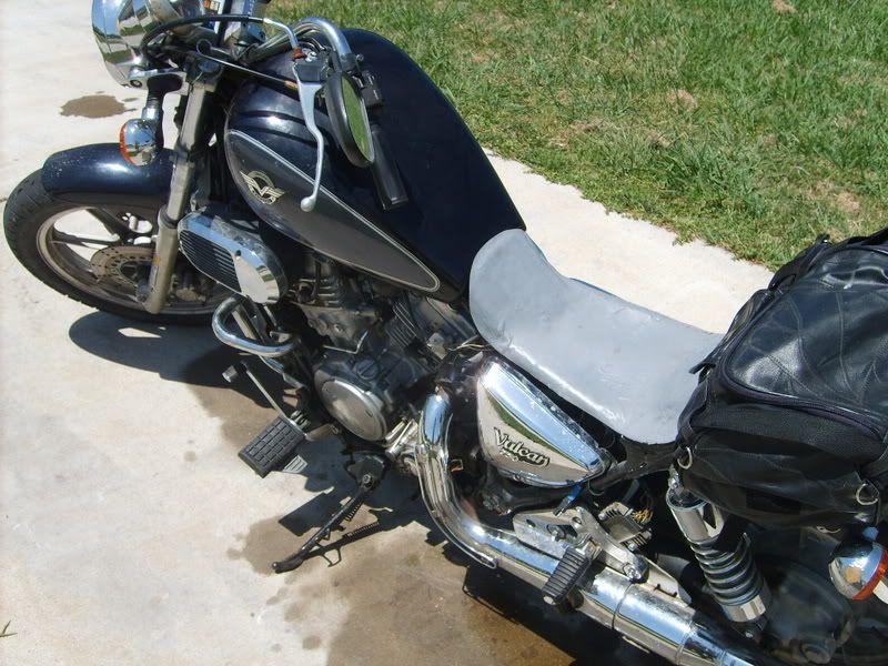

I rode the bike around for a week or so with just the pan to make sure that the pan was comfortable by itself, so I could make changes if necessary.
I then used www.DIYSeat.com as a guide to pad and cover the solo seat.

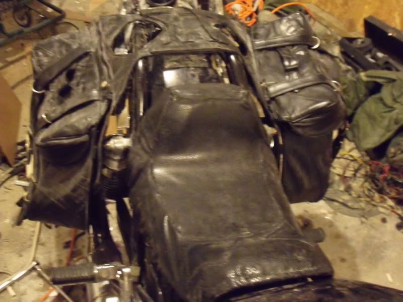

Then I covered it with leather to match my saddle bags.
post #10 of 13 (permalink) Old 09-02-2012, 09:50 AM

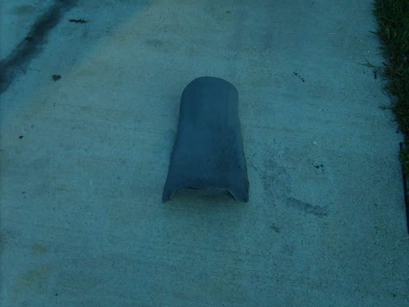

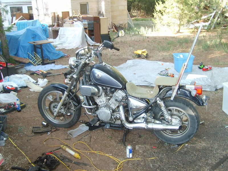

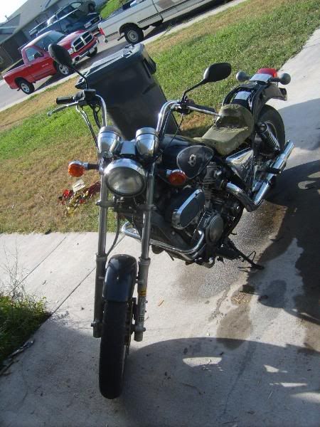

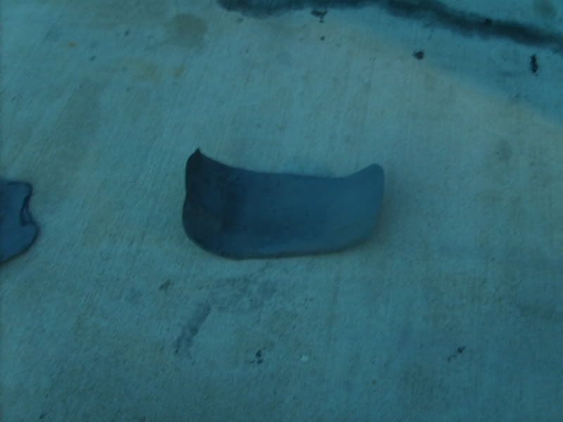

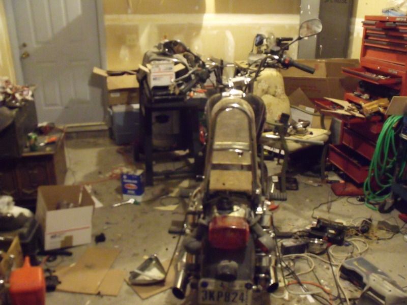

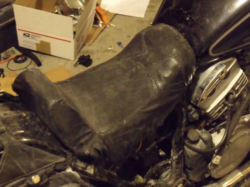

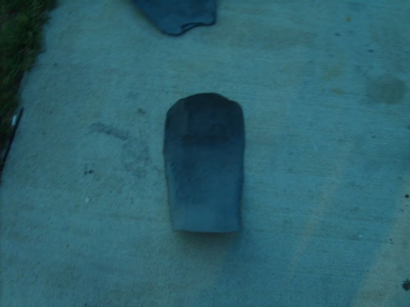

As this seat was always suposed to be a convertable Solo/2-up seat it was only a matter of time before I started to brainsorm the Queen portion of the seat.
Epic Fail 1(the plywood broke with my 30 lb duaghter sitting on it in the driveway before we even went for a ride)
I tried to make a tractor seat style Pan out of fiberglass
Epic Fail 2:
Then I went back to Jeffery Phipps way of making a seat pan and came up with my final pan (which seams to be working grate now).
