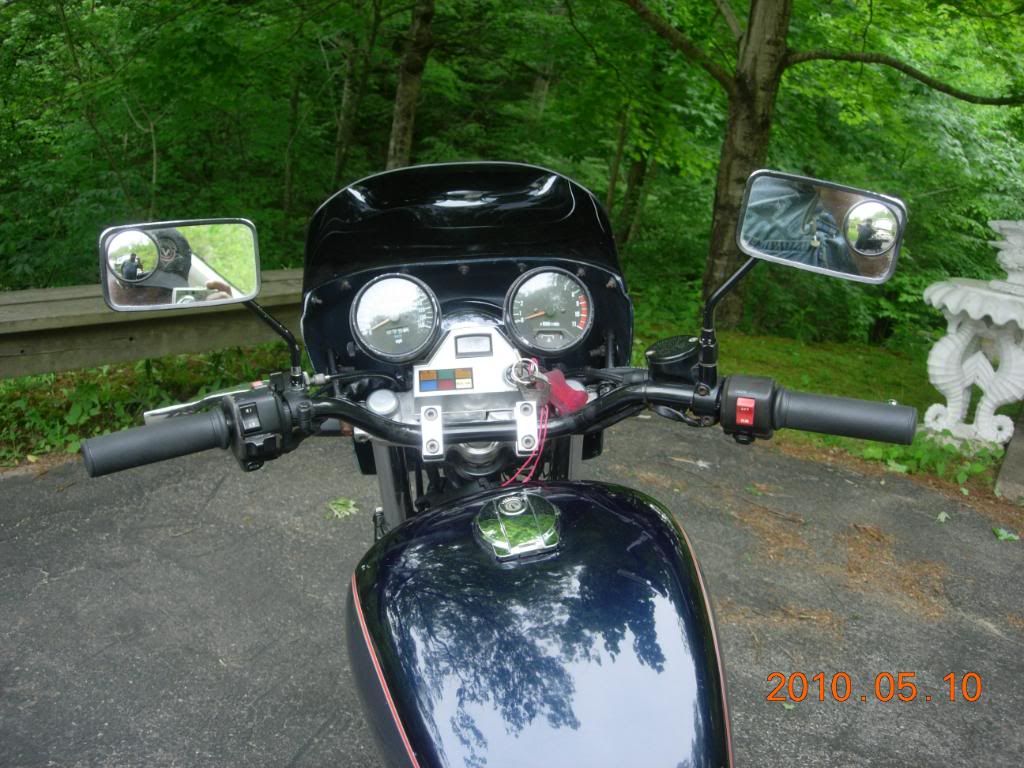

here is what I put on my 750 I think they were around twenty bucks from JC Whitney they were called Daytona bend,and I didn't have to buy risers,I did however switch to a KZ1000 clutch cable yo do away with the the curved fitting on the end of the cable where it goes into the lever.Those are the stock riser caps with the Kawasaki emblem cut out of the middle and dressed with a file and then polished out,not necessary but I liked the look of individual clamps.
