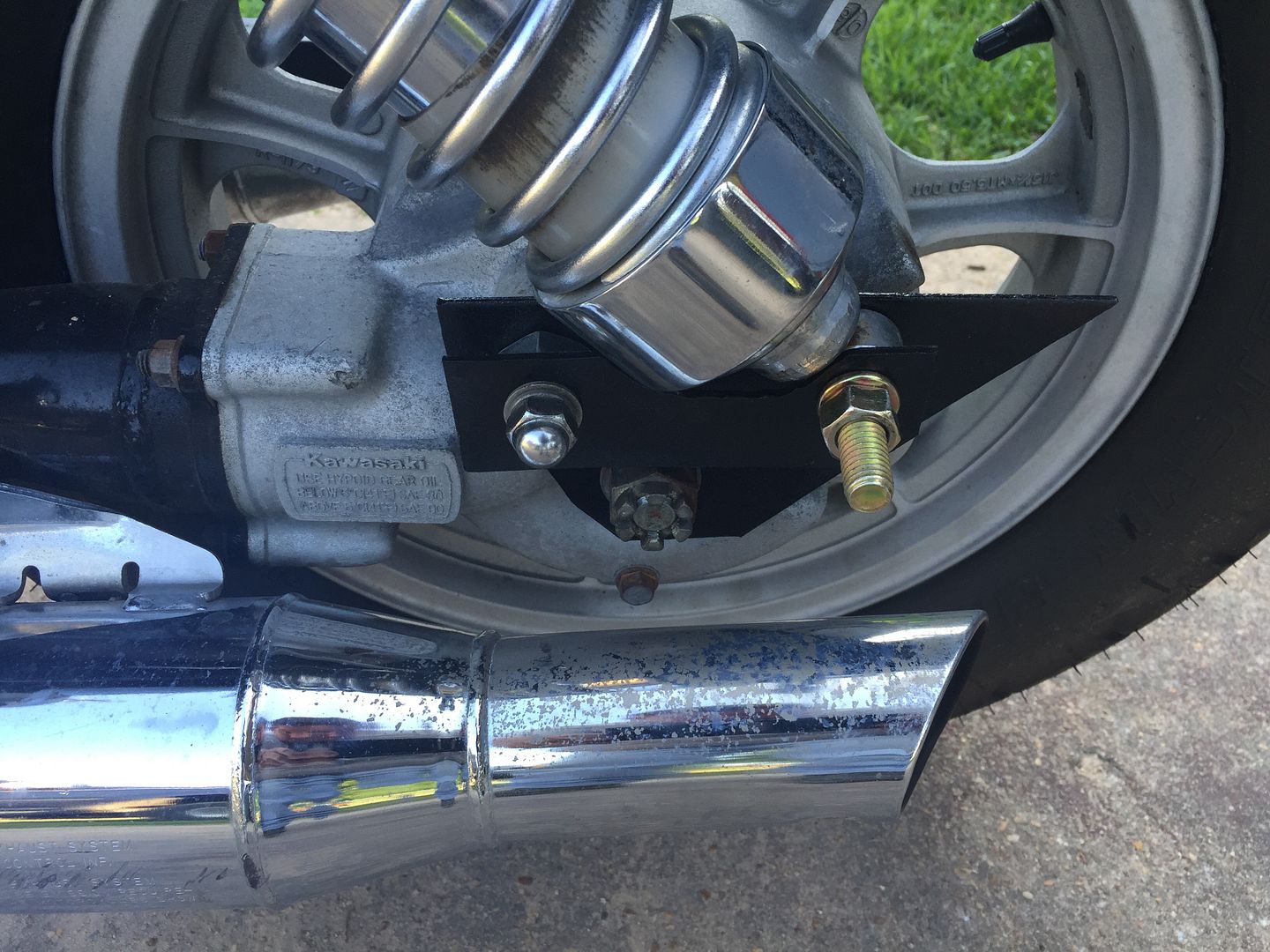

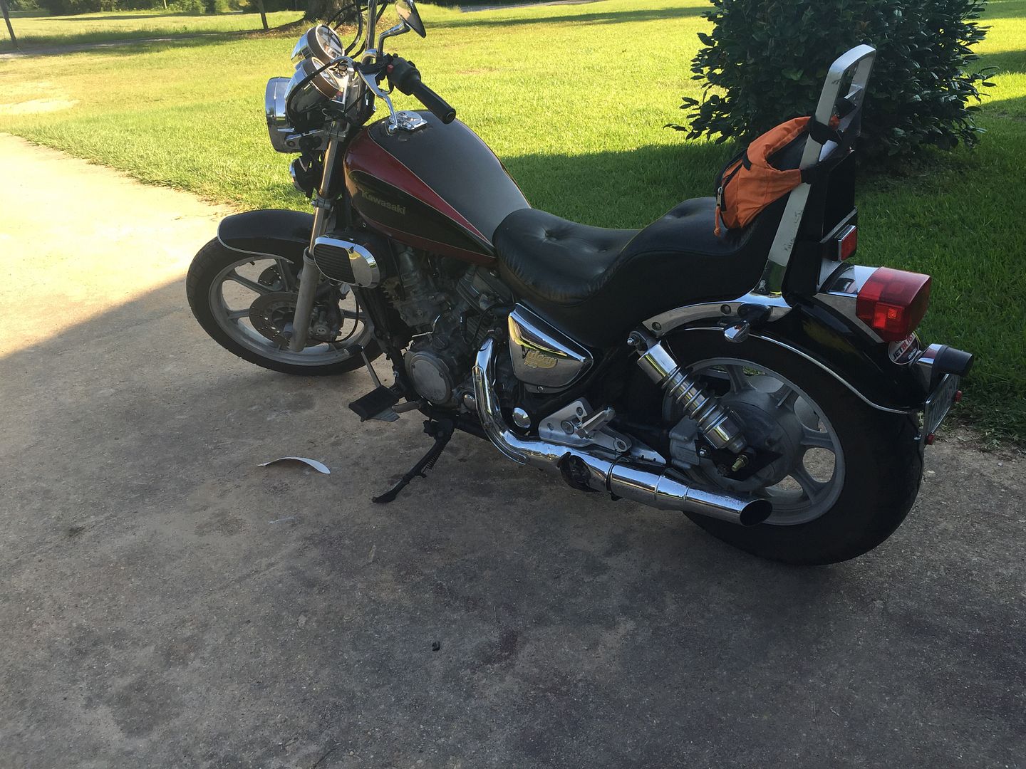

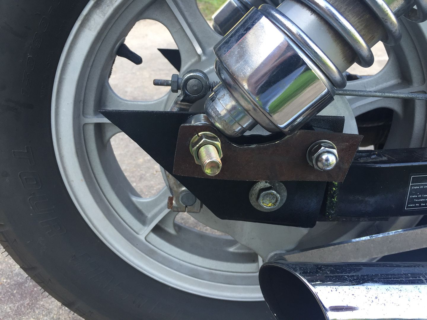

Actually, it's a "lowered my Vulcan" thread. I did the 1/8 plate with a shackle relocation bracket, and raised the forks just a hair under an inch. I got finished about the time the wife and kids got home so I haven't test driven it yet. It feels pretty good sitting on it, the back seems pretty stiff. I'll end up pulling the bracket off and just changing shocks, but I wanted it lower today and didn't want to wait. I'll post pics tomorrow or over the weekend.

I did it because I'm a short guy. I took it a bit over 100 miles yesterday, no bottoming out on the railroad tracks or bumps, but I did drag the center stand a time or two.
I started off with big triangles and worked them to shape. I didn't cut the rear of the brackets down because my wife proclaimed the pointy bit "bad ass."
