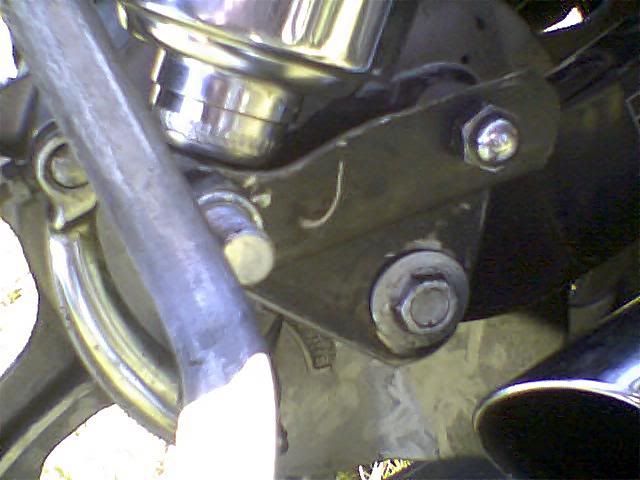

I made mine out of flat plate.. and of course you don't have three holes.. you are using your stock shock mount and the axle for the first two holes, and the third hole is your new shock bolt.
another note... those cad drawings aren't quite right.. I had to tweek them a little bit to get the holes to line up and the brackets to clear the shocks.

Slim, Im with you on that side, but the other side...
I did the exact same thing to the other side... I posted the hard side to configure.. which was the brake side... the final drive side was cake.
