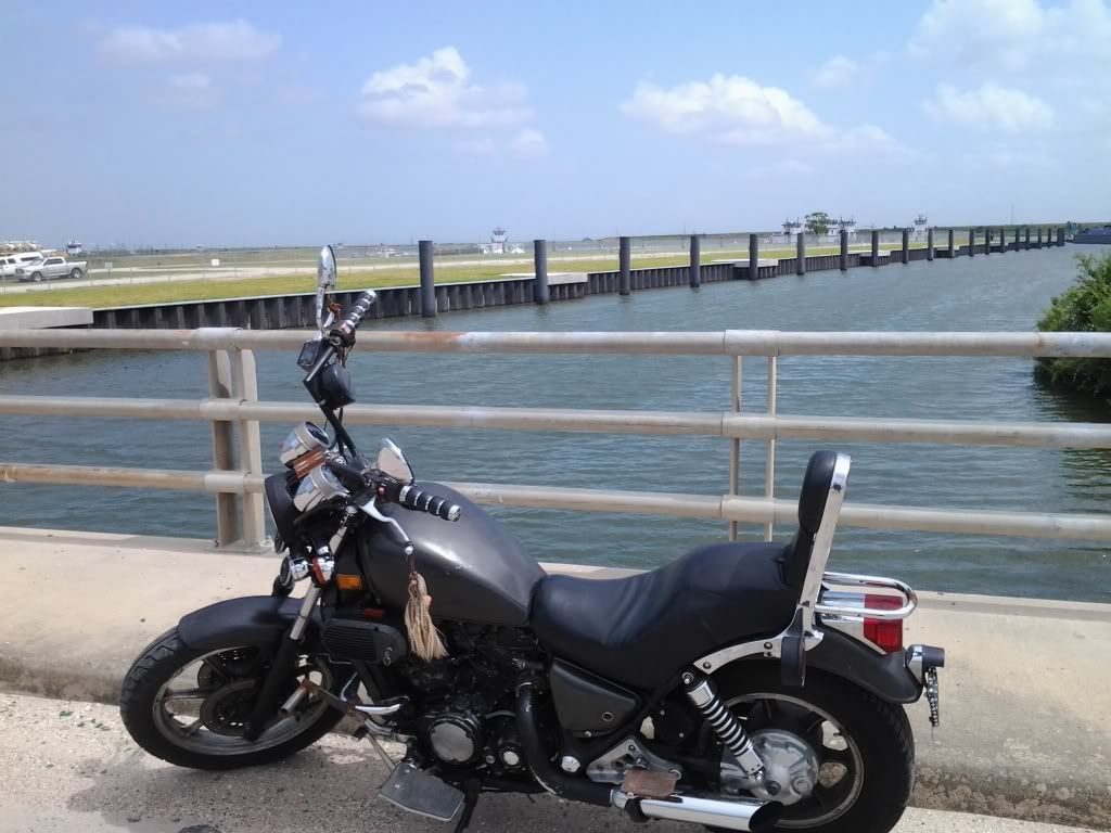

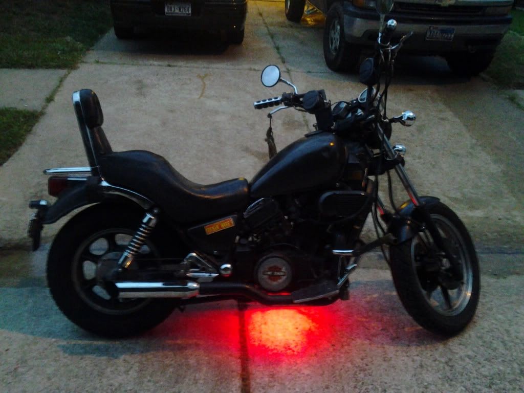

@newrider- do you have any pics of how i looks with the 11" drop..
Arob559 is offline
post #5 of 19 (permalink) Old 08-09-2013, 04:40 PM
yup here ya go

Your bike looks soooo good!!! Is that a red LED under the engine??
