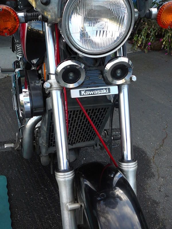

Got candy apple red stainless steel brake lines from Pashnit today, had the local shop install them. Going for a ride tomorrow, will report on their performance later.
Looks pretty good.
View from the cockpit.
No more ugly black hoses. Sweet! They match my red spark plug wires too . =)

Originally Posted by KIMMERLING View Post
Whats the part numbers and how can i install them..they seem different then stock where they join the brake reservoir
Looking at the pictures, the difference appears to be two separate banjo connections and brake lines running from the MC reservoir down to the calipers.
The OEM brake line assembly has a single banjo connection on the MC reservoir with a single line to a splitter behind the horns, and two lines running down to the calipers from there.
I`m guessing the company is savvy enough to sell the set of two SS brake lines, (which is marketed specifically for the vn750), with a longer banjo bolt to connect the two lines to the MC reservoir in place of the one line bolt that is original to the bike.

I have those lines in the carbon fiber (smoked) finish. I love them ....good Quality and easy to install. It does not use the splitter tank on our front forks. Both lines get stacked on the output of the master cylinder.
