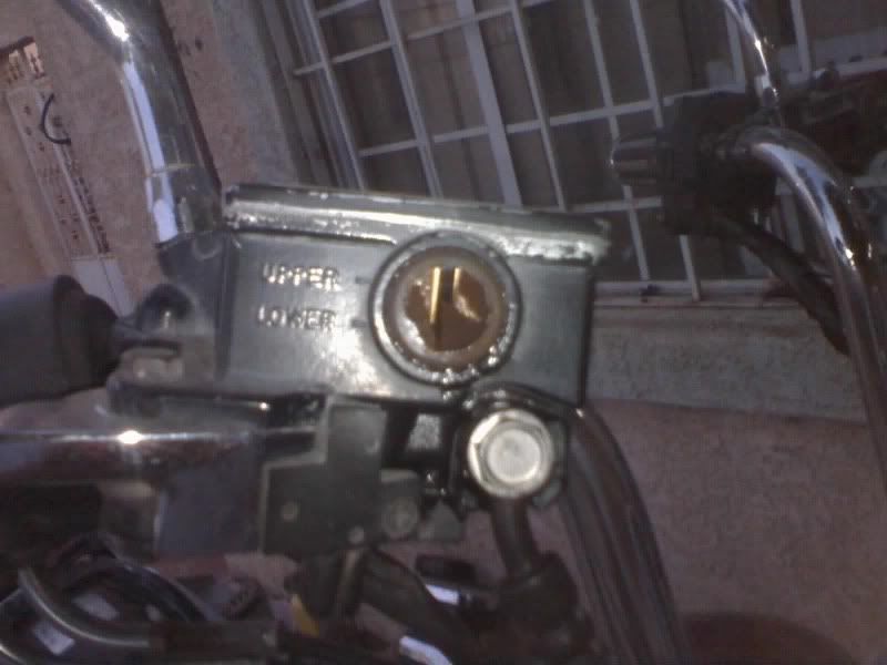

Well, this was supposed to be a good weekend for my VN700... I managed to clean the carburetors and put them back in, I had already changed the oil, I replaced and relocated the R/R, I got a fresh battery (not AGM, but fresh), I did the marble thing for the reed valves, I changed a bunch of old dried up hoses... everything was going ok, and then I look at my front brake cylinder and there's this sight thing on it to see the level of the fluid, but it looks kinda dark, so I rub it with my finger to see if it clears up...
Well, the sight glass (plastic it seems) seemed to disintegrate!! It just broke with just rubbing it with my finger!! I was soooo pissed off... think it can be fixed or plugged or something, or am I just doomed to buy another cylinder?

That's a new one..... I think I would try to plug it somehow. Do you know anyone good at welding aluminum? That might be an option.... I don't know. Looks like the cylinder is sold as an assembly: 43015-1283

I don`t know if there is any way to repair a broken sight glass on the master brake cylinder. Maybe check with a watchmaker to see if he has a watch crystal of the right diameter to fit the hole, and silicone it in place. Not the prettiest fix, but maybe functional??? The brake fluid in the reservoir is not under pressure, only the fluid in the brake line in front of the brake piston operated by the hand lever.
Here is a whole front brake assembly off a 1986 model, on ebay for $60. The rectangular MC was used from `85 to 1990.
http://cgi.ebay.com/ebaymotors/KAWAS...Q5fAccessories
Another one off a 2003 for $297. (This one has a round master cylinder used from 1991-2006, but with the hand lever included it should be a straight bolt on. The brake hand lever shape is different for the rectangular and round MC.)

Thanks guys, I had already checked ebay, so I posted another thread here to see if someone has one for sale. I like that watch crystal idea... I don't care if it doesn't look that good, just want to ride the bike. I do have a master cylinder from my EX500, they are the same except that the one on my Vulcan has the thread for the mirror and the EX500 MC doesn't have that. I can use that one in the meantime until I get a Vulcan MC or maybe get different mirrors that attach differently(?). I'm not sure, gonna scout my options... I did want new mirrors, so if I can find some that don't mount on that particular hole, it'd be great.

85'-90' M/C sight glass "mineral glass" AKA watch crystal
http://cgi.ebay.com/ebaymotors/86-ka...Q5fAccessories

I'm thinking that you need the original replacement where it is a pressurized system like in a car. Maybe not as much pressure but still a vital piece of equipment. If you silicone something in place it could blow off when you hit the brake and that would suck if you are in a predicament. I would try and find a new/used brake cylinder.

Baldy: I don't think there's pressure in the reservoir, I only rubbed that thing and it broke, if there was any considerable pressure it would have been long gone I think lol

You may be able to make one out of clear plactic. Be sure to test it with brake fluid to see if it will not melt. And use a light bit off silicone to seal it into place.

right i'd say get a thick piece of acrylic and cut the circle and either weld-bond, epoxy, or hard silicone it into place, or a combination of those sealing techniques. ought to be fine
