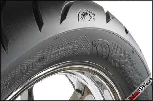

Looked at the Avon Cobra and it looks like a really good tire. Quite a few people are saying they're glad they ditched their Metzelers for the Avon. They're a bit more pricey but all info says worth it. The Avon Cobra is on Ebay, tread pattern very similar to the 777, so I like that too. There's little cobras imprinted on the edge of the tread, the chicken strip area. They claim if you cut the cobra's head off, you know you're doing it right. They also have a jazzy snakeskin sidewall.

Shinko 777
Avon Cobra
And now I see they had some sidewall issues in 2011, another page discussing this has been deleted, sidewall pics here: Avon Cobra Warning | Big Dog Motorcycles Forum
