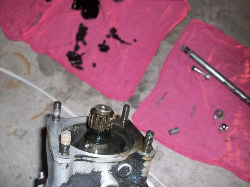

It sounds like your drive shaft splines may be shot? For 2xxx miles that's amazingly bad luck, could have not been lubed from the factory.
Take the rear wheel off, and then the rear final drive. Look where the final drive and the shaft meet. Is it ground down to dust on the final drive? If so, it's shot.
If it DOES end up being that, I do have a good spare I could sell for 85 shipped.
Here is what it SHOULD look like.
X 2 Anouther unlubed driveshaft bites the dust.

Just removed my tire and checked spindles and the are fine.. Nice and lubed up so I know that's not the issue. Next would be to try to adjust the clutch cable! If that doesn't work changing out the plates. Or should I go straight for the plates? Can anyone help with cable adjustment?
