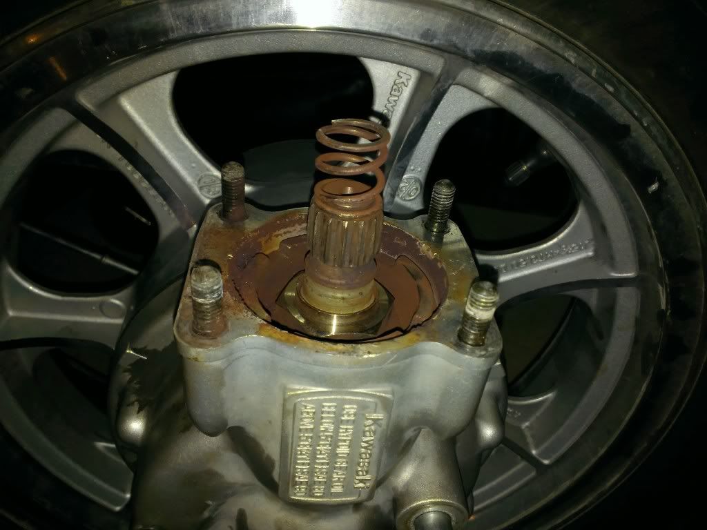

Dude, we need visuals. I'm sitting here thinking about this and none of it makes any sense. I had my FD off not that long ago and the FD spring is not that big and I wonder if there is even enough space in the coupler for the drive-shaft to move back and fall out? As for the shocks, I think the inner rod would have to pull out of shock body just to allow the rear tire to drop far enough for the DS to fall out.
A weird problem indeed!
Here is a pic of the spring in question:
