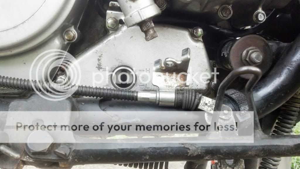

So, I'm just about finished putting the bike back together after removing the engine from the frame.
two things I cant quite figure out.
1. Where does the bracket on the engine side of the clutch cable attach? Anyone able to provide a photo of how this attaches?

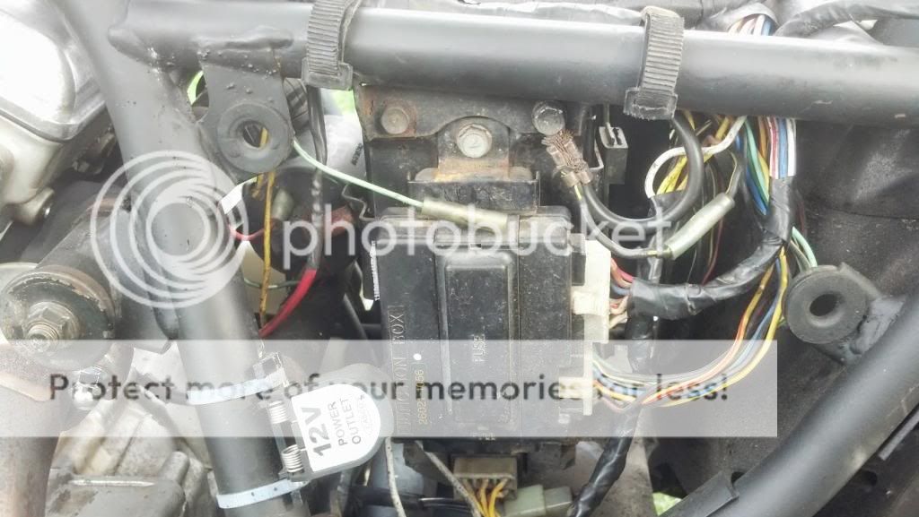

2. Near the battery box and next to the stator wires, I have a single (green) wire I can't find where it connects to, anyone have a suggestion here

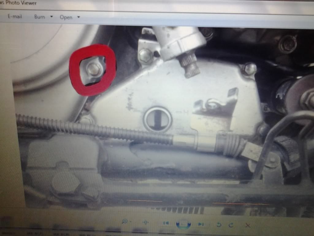

the clutch cable bracket goes here
the green wire plugs into the other green wire coming off of the nutral switch located bottom back center of engine

post #4 of 5 (permalink) Old 05-31-2013, 01:35 AM Thread Starter
Ndr
Join Date: Feb 2010
Location: Pittsburgh, PA
Posts: 856
Awesome.
Thanks!

OK, So apparently I lost that section of wire that connects between the neutral switch and the wiring harness. I looked all through the yard in the area I was working and no luck.
Figures I'm looking for a green wire in a section of grass
Seems like the thing grew a set of legs and just walked away. *sigh*
Trying to think now how I can make one up.
Will a bullet style connector attach onto the neutral switch if I can find one small enough?
