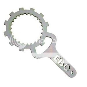

X2 on that, and don't try to put the bolts back in the hub to hold it in place. I tried doing that and bracing between the bolt and snapped one of the mounts right off. Aluminum isn't that forgiving. EBC makes a clutch hub tool that fits our bikes or if you have a set of the metal clutch plates you could probably fab one to work like this one. My cousin had a grabbit tool I borrowed to hold it when I torqued mine back on
