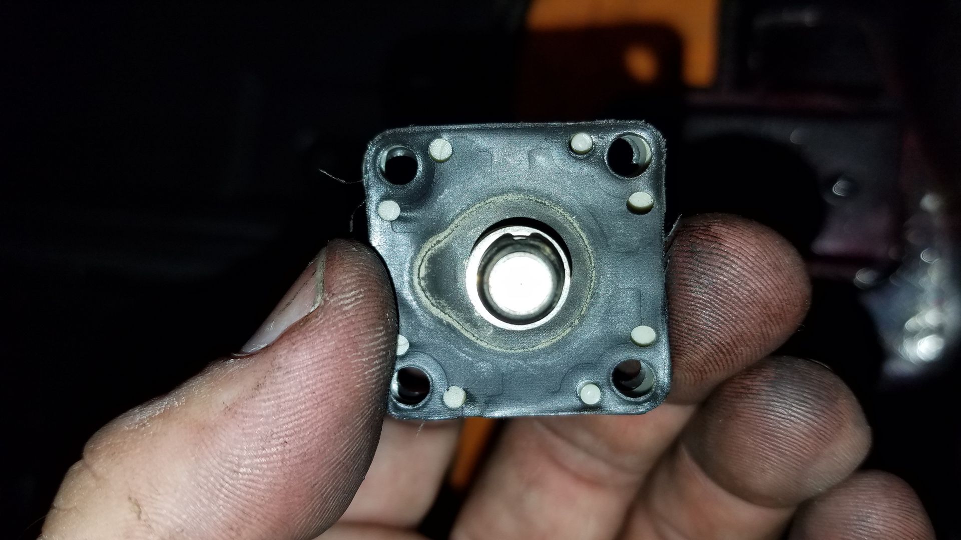

When I rebuilt the carbs the other night I did all the proper checks, including setting the floats by turning and blowing the tubes, and they checked out ok. I'm guessing the gas is acting as a micropenetrant and getting by a flaw in the float needles. I know however that I've had several bikes with issues relating to the petcock not shutting off and the overflow out the carb throat has flooded the cylinders before so that's why I was curious about that. I've visually verified the oring on the petcock vacuum rod is defective. See pic below, it got pinched and is missing a chunk so it isn't sealing and shutting off. If you shut the bike off and open the fuel bowls on BOTH CARBS they will run forever until the tank is dry unless you manually shut the fuel off.
I need to know if the petcock vacuum regulates a particular CFM based on vacuum or is open fully when the bike is running. I suspect it's wide open and leaves the carb up to fuel regulation, but I don't want to guess. It'll matter what size oring I go back with.
I shut the petcock off manually and the cylinders do NOT flood so I believe this is my first and primary issue. The overflow on these carbs seems to be internal on the carb? If so it would leak through the carb and drain back into the cylinders.

I'm pretty sure the o-ring only seals the 'handle' ... the knob you use to turn it on-off-reserve, or 'pri'. ... seals that part against the petcock body so no fuel can leak to the outside. Have only done this petcock once, so I may have forgotten if there's more than one o-ring.
You're thinking of the large oring regulating the main between off, res, and on. I'm talking about the one pictured above that regulates fuel based on vacuum which I suspect opens more with more vacuum (throttle) based on the diaphragm and spring that is like the one on the side of the carb. That would explain some issues with richness under certain conditions if it is wide open with a bad ring. While the floats are regulating this, the overflow feedback is adding to the issue and bypassing the floats.

Ok, the o-ring in question is on the metal center plunger?
