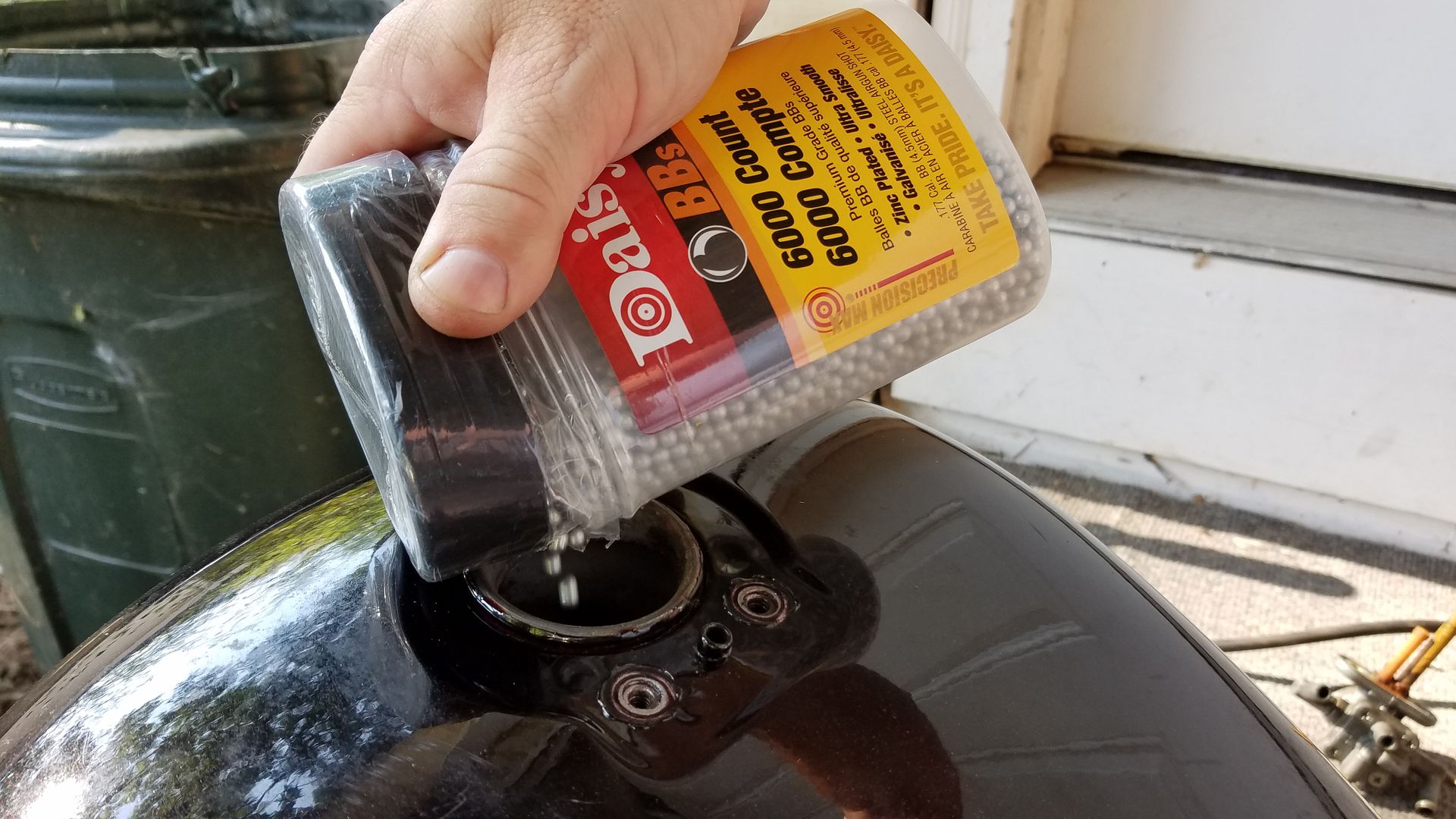

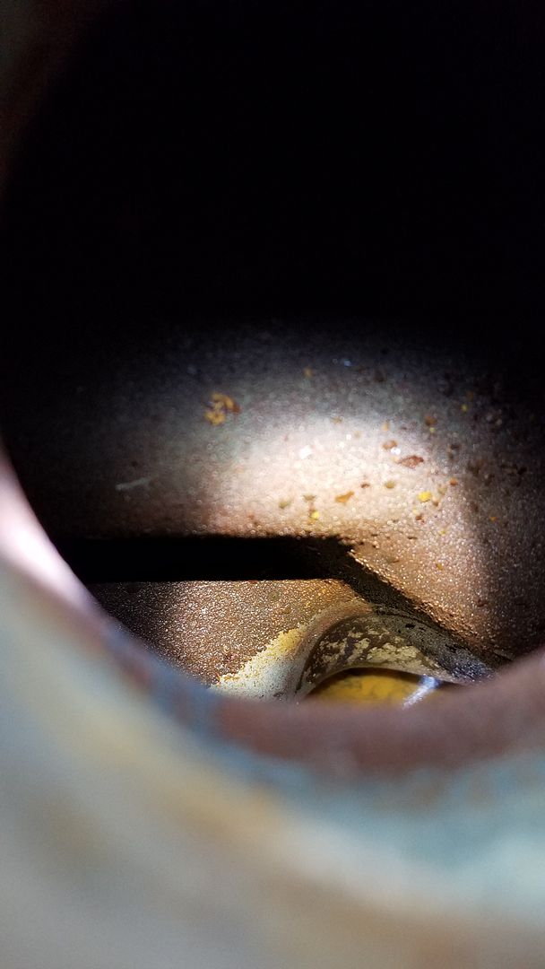

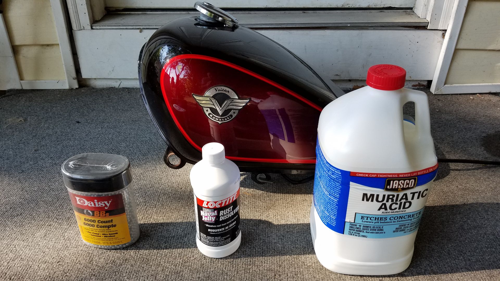

You can get instructions on how to do it in the acid thread sticking to the top of the forum. I wanted to put these pictures out here for people to see what the process is like. Simply do as the thread says and everything will turn out excellent, though I only needed about 5 minutes of shaking the bb's for my tank to be cleaned your results May Vary. it was pretty Rusty but this seems to act very quickly.
Tada!

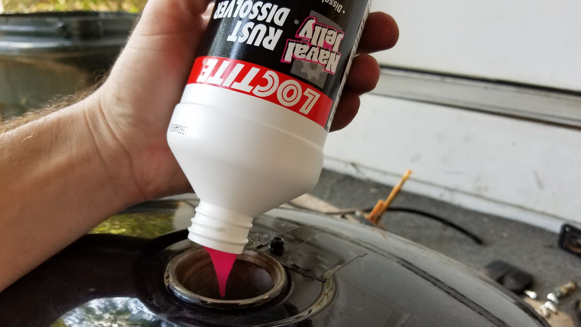

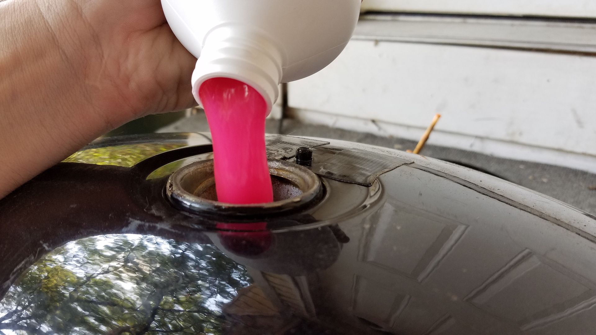

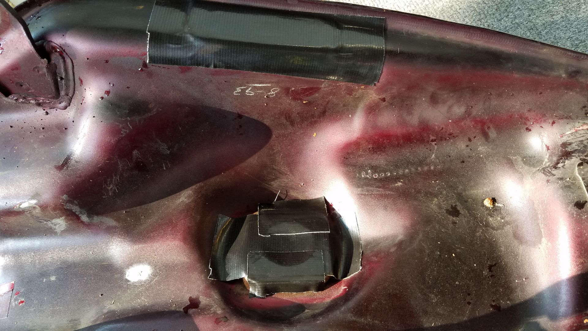

I just pulled all the accessories off of the tank and sprayed it out then taped it up, poured the bb's in and the acid. Shook it for 5 minutes washed it out and poured the jelly in. After that you're home free. Just shake the jelly around for a minute every 20 mins for an hour and wash it out. Total time was about 1 hr 20 mins. It looks like brand new and it was naaazzztttyyy.
