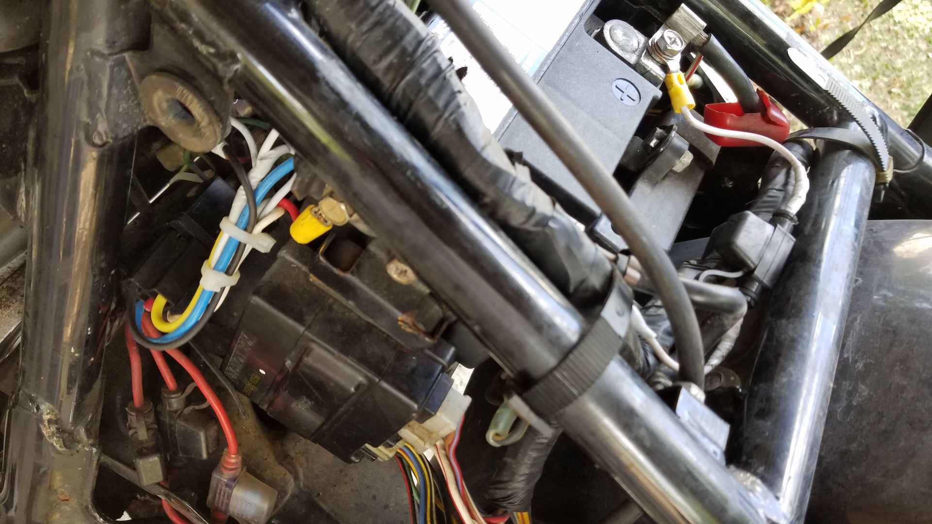

Well hell, Did the ign coils mod with a relay and fuse and didn't help. Onto other things. Keep the suggestions coming.
Suspecting the petcock could be leaking into the chambers, I turned it off when I got off the bike to see if that could be an issue and it wasn't affected. Still hard to nearly impossible to start when warm.

Nice pictures of a clean job.
Have you pulled a plug to check the quality of the spark when hot?
