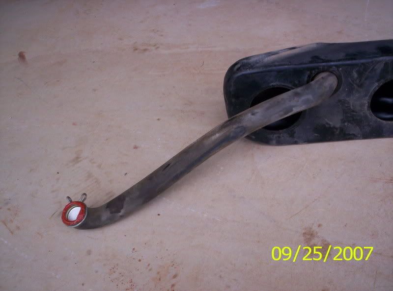

here is the crankcase vent hose
http://i35.photobucket.com/albums/d1...r/000_0034.jpg
thanx to niterider for the pic

my bike came with pods air filters from the previous owner but no smog plumbing. just open reed valves, so i want to coaster them. that pic is ok but still cant tell where it enters the cylinder. if i am looking at the front jug there is a boss(?) just to the right of the exhaust. could that be it? seems to be plugged. thanks, hr

I think this may be what you're referring to - it's a hose linking the airbox to the front cylinder. It's only sorta part of your smog plumbing, in the sense that there's a hose from the airbox to the emissions canister, and hoses from the canister to the reed valve covers. So, fresh air to the combustion chamber. Jon Landau (93VN750) did both the ear shave and coastering - you might post him a pm and see how he dealt with that particular vent.

I new these pics off ebay would come in handy. Do you see the black hose to the right of the manifold. Thats it. This is a front on view.

That's a good pic, Jason. Hoodrat, transfer that black hose coming up to the right of the manifold to my pic, where the hose is coming up (from the right of the manifold) to the airbox. I'm guessing in Oglejust's pic, the hose is now hooked up to a pod?

thats the one. i shot some carb cleaner in the front cylinder to clean off the gunk and thats what is there BUT with a small brass cap in it. i assume the old owner did that. i will run a hose and small breather on it. thanks for all the help. hoodrat
