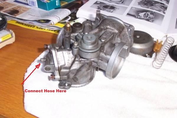

I think he means blowing aerosol carb cleaner in through the carb bowl drain.

actually, I am meaning place a hose on the float bowl drain nipple and using a turkey baster or other kind of syringe inject seafoam right into the carb body. by using the drain port, the fuel will backfeed through both the pilot and main jets.
