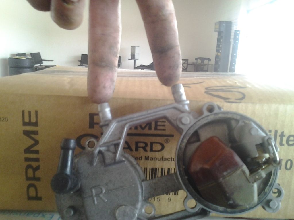

there are two hoses that connect to the top of the float chamber on the carbs they tee into each other and the one hose coming off of the tee is usually tucked into the right ear but since you have shaved those puppys off you need to tuck it back under the tank out of direct air flow or the wind whipping across it will cause the slugging you describe
at idle you dont feel it cause there is little wind and at WOT you are pouring in enough fuel to not notice it
its the hoses that come off these things at the ends of my fingers
