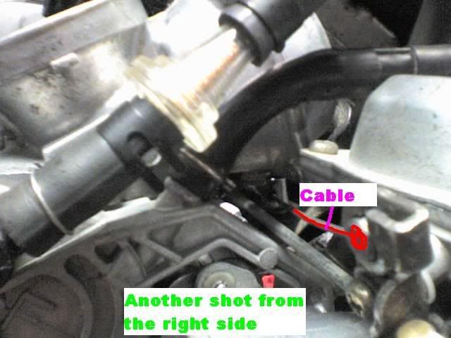

I guess it was a case being to close to the problem. that fixed it. so thanks a ton. But... I bought a choke cable from RomeoBravo, But I can't seem to get it mounted correctly. I think it is on the carb properly, but there isn't enough tension on it to pull.... is it supposed to mount on something near the carb?

Dosn't the choke cable actually push the plungers in, not pull out?

It pulls them out. In is closed, out is open.
