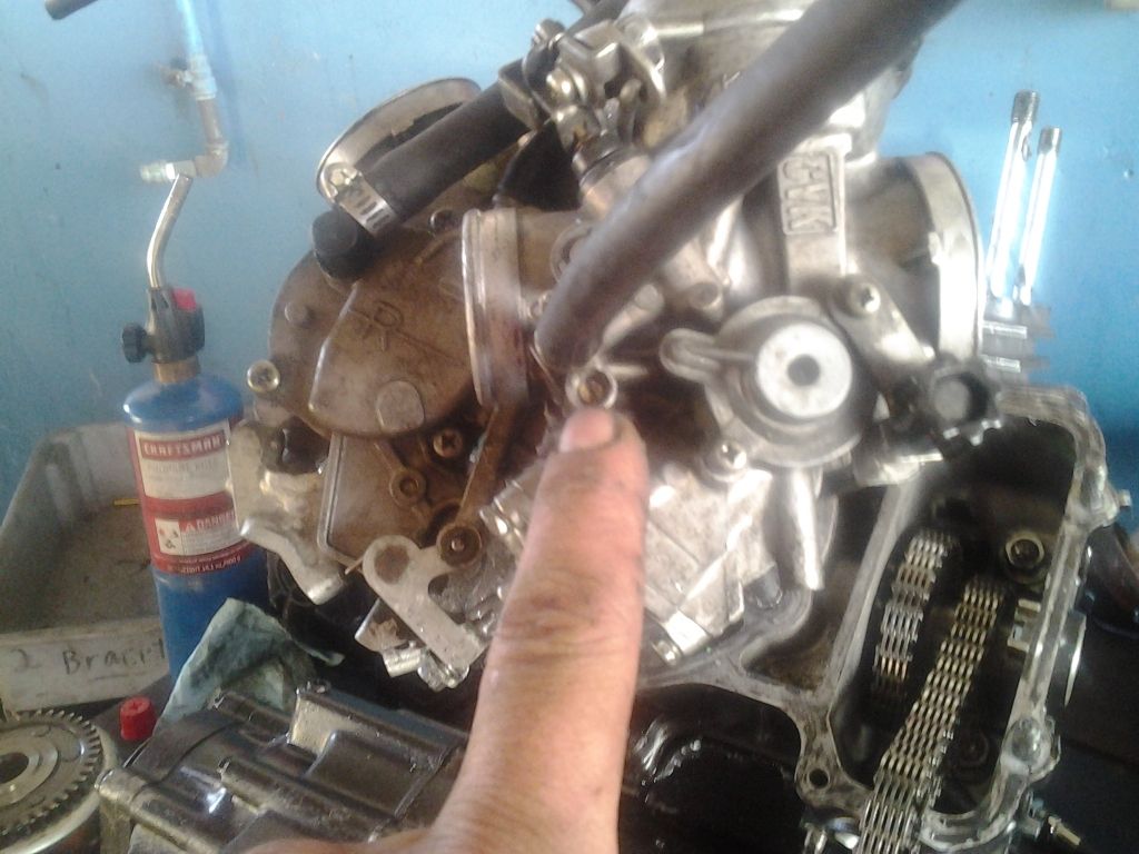

hold on im gonna get a pic for you
post #3 of 10 (permalink) Old 08-16-2012, 09:14 PM
that is the air fuel screw at the tip of my finger of course there is one on the other side as well on our vulcans going in is leaner and out is richer 2 1/2 turns out is stock settings and if they have never been fooled with there may be metal caps covering them you only have five turns before they fall out hope this helps

Cool..Thanks
I'm working on removing the lead plugs right now..Unfortunately it just started raining cats and dogs here so a test drive will have to wait till morning,. Thanks for the picture too!! So far the forums have been WAY more helpful than any other place i found on the internet.. Glad i signed up.. Thank Again.. Hopefully my next post will be about how awesome she's running..
