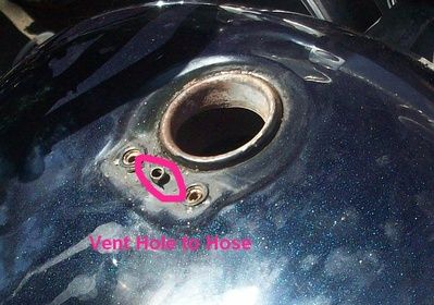

Got the common gas cap problem yesterday, bike would bog down. Rode the bike with the gas cap open and problem resolved so I cleaned the gas cap and no more problems. I took pics to help anyone with a similar problem.

You can now put everything back together. Also check the gas tank vent. I used a compressor to blow out the vent hole in the tank. On the underside of the tank is a rubber vent line running to the rear wheel. Make sure the tank vent and rubber line are clear.
