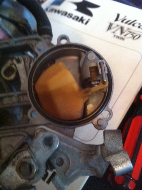

My floats are discolored (see pic at bottom), but I think that's cuz half of the float was sitting in gas for almost 2 years. If I submerge the float in water and don't see any bubbles and it floats on top, they should be fine, correct?
What about the float needle? If it looks clean, is it fine?

My floats are discolored (see pic at bottom), but I think that's cuz half of the float was sitting in gas for almost 2 years. If I submerge the float in water and don't see any bubbles and it floats on top, they should be fine, correct?Your correct, theres no holes in the float.... discoloring comes from gas on the brass
What about the float needle? If it looks clean, is it fine?clean it with a scotch brite pad, the tip is usually what gets the dirtiest
