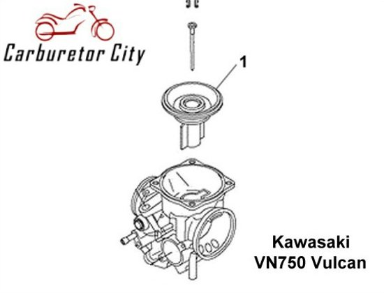

In that case, it may be a bad diaphragm. That's the round rubber part under the round cover on top of the carb.
The butterfly is the flap that rotates open when you twist the throttle. The butterflies on both carbs should begin to open at the same time. It's the plate with two screws seen in the center of the carb below.
I would look at the diaphragms first.
Carb Diaphragm Part #1 below
