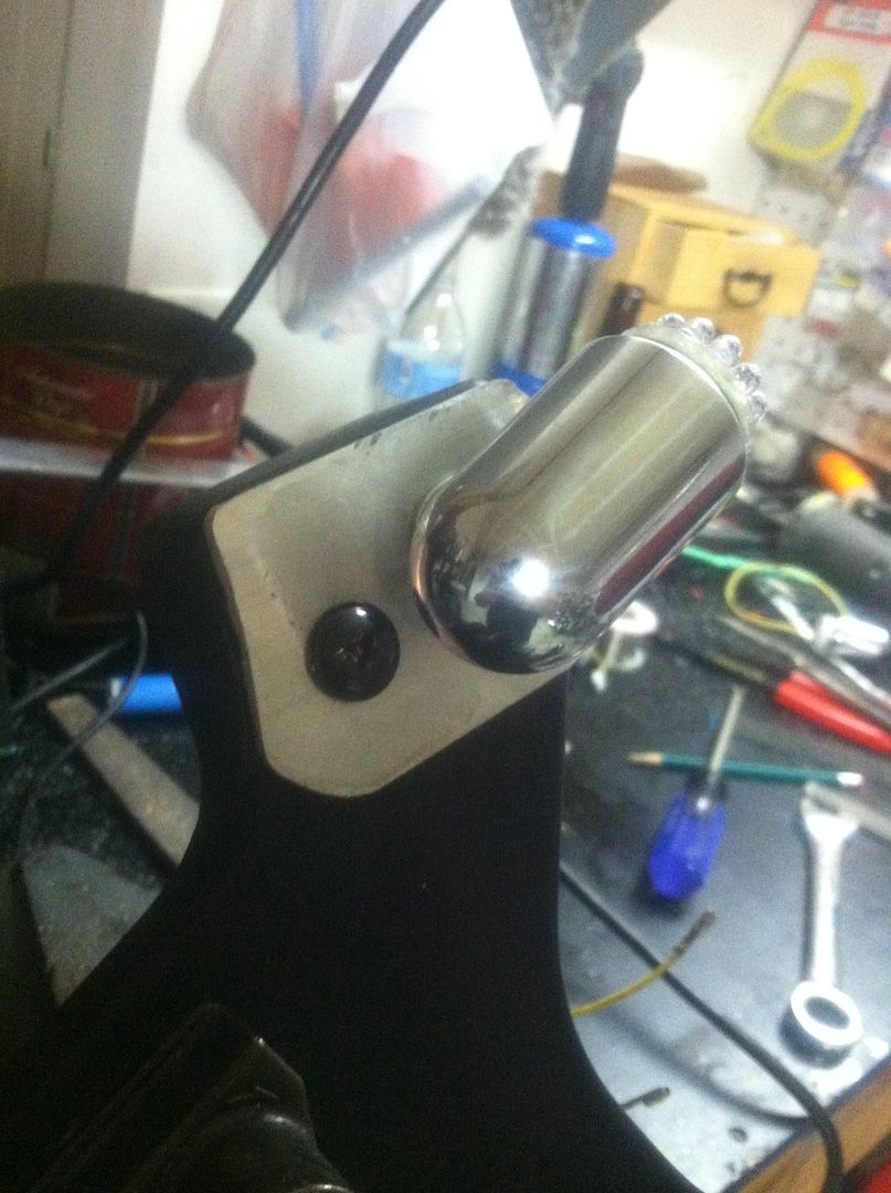

Guys I got my lights in and the rear turn signals installed, what do you think?
this is the light strait out of the package.
this is them installed and ready to go.
Here they are with the flashers on, its not a very good pic but its goodn to see how bright they are.
This is the mounting plates I made from aluminum flat stock so I could mount them in the original place as toe others with out drilling unnessary holes in my bag mounts.

I just received my new eBay turn signals and they look great for $10. I like the LED and I like that its simple to replace the flasher unit rather than install the resistor ballasts like I did on my sisters R6.
My question was about mounting them, ours have the twist lock base with the screw off to the side. The new ones (all except OEM) are a single stalk with the wires protruding through the stem.
I love the simple plate scott42 made and that is the answer to my question. I assume I can make these from whatever aluminum or steel stock I have in the shop.
