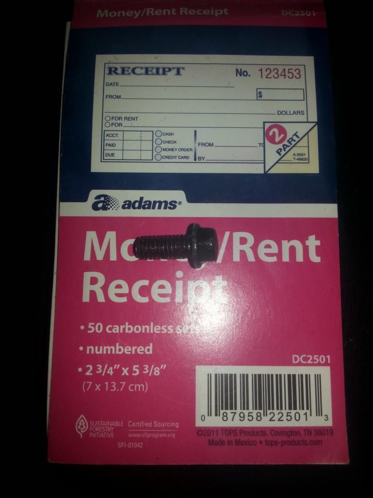

I pulled the outer stator cover to take some measurements for the alternator mod and this fell out from behind it does any one recognize this bolt

post #5 of 33 (permalink) Old 10-20-2014, 04:42 PM
scott42's Avatar
Join Date: Aug 2014
Location: arlington tx
Posts: 139
looks like the bolt that holds the flywheel in place to me. The damper bolt is gold in coloer if I remember correct from exsperiance.

post #6 of 33 (permalink) Old 10-20-2014, 06:53 PM Thread Starter
I can ensure you that it is not the flywheel bolt since this one is an 8mm head
I put it on the receipt book for size reference the book is 2 3/4 of an inch by 5 3/8 of an inch
post #7 of 33 (permalink) Old 10-21-2014, 12:42 AM
Ndr
Join Date: Feb 2010
Location: Pittsburgh, PA
Posts: 856
only bolts with and 8mm head I can think of on that side/area would be for the cam chain guides, but I'm pretty sure all those were all zinc coated bolts and not black.
Ndr is offline
post #8 of 33 (permalink) Old 10-21-2014, 09:36 AM Thread Starter
yeah those were zinc 10mm for the chain guides
post #9 of 33 (permalink) Old 10-21-2014, 09:41 AM Thread Starter
I figured it out I had that bolt holding my left side ear on and dropped the bolt I thought I lost it in the grass but now that I think of it I did have the oil fill cap off at the time
i'm just glad that's all it was and that It didn't do any damage
