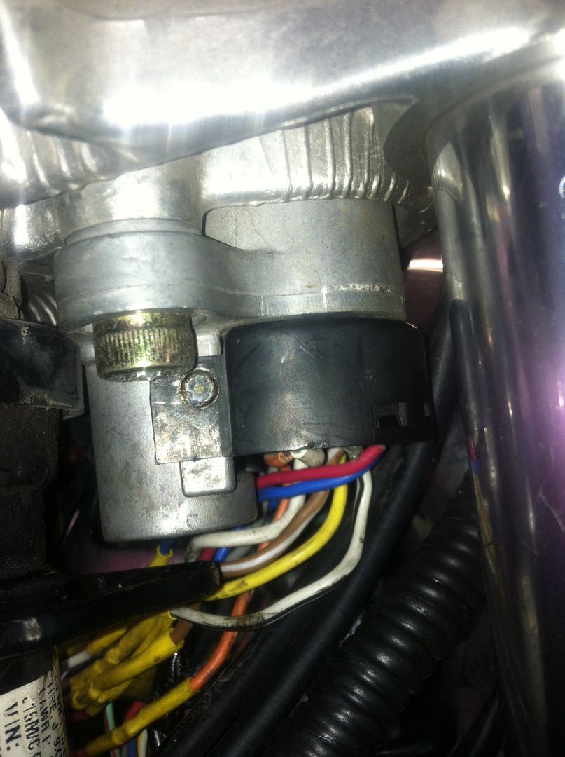

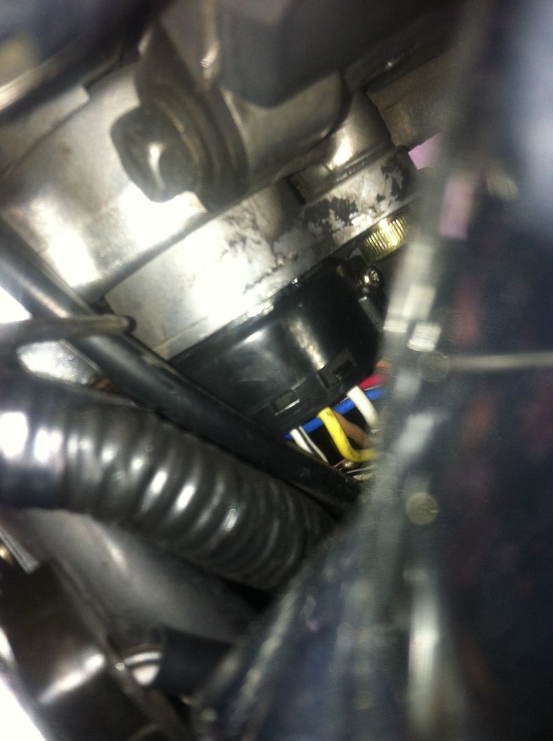

I had that same identicle problem, mine was from the wiring harness that attaches to the key igition,every time it would move it would loose contact and die.My suggestion would be start the bike, locate the harness of the key and wiggle it without moving the handle bars and see if it dies or not. Thats what was happening with mine. My simple fix was to place a small washer in the gap to keep it from moving around and adrop og super glue to hold the washer in place. I havent had the problem since doing it. I will try to post a pic or two for you.

In the top pic if you look you can see just a small washer in between the harness and the key ignition, thats what my problem was and this was my fix.

Thanks Scott42, that seems quick and simple I WILL be trying this tomorrow morning.
