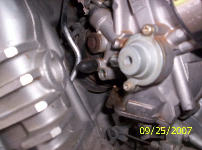

There is also a vaccuum hose that comes off the right side from the rear carb. If the valve has a busted diaphram you will get raw air into the cylinder.
Here is a pic where I plugged after coaster job.
