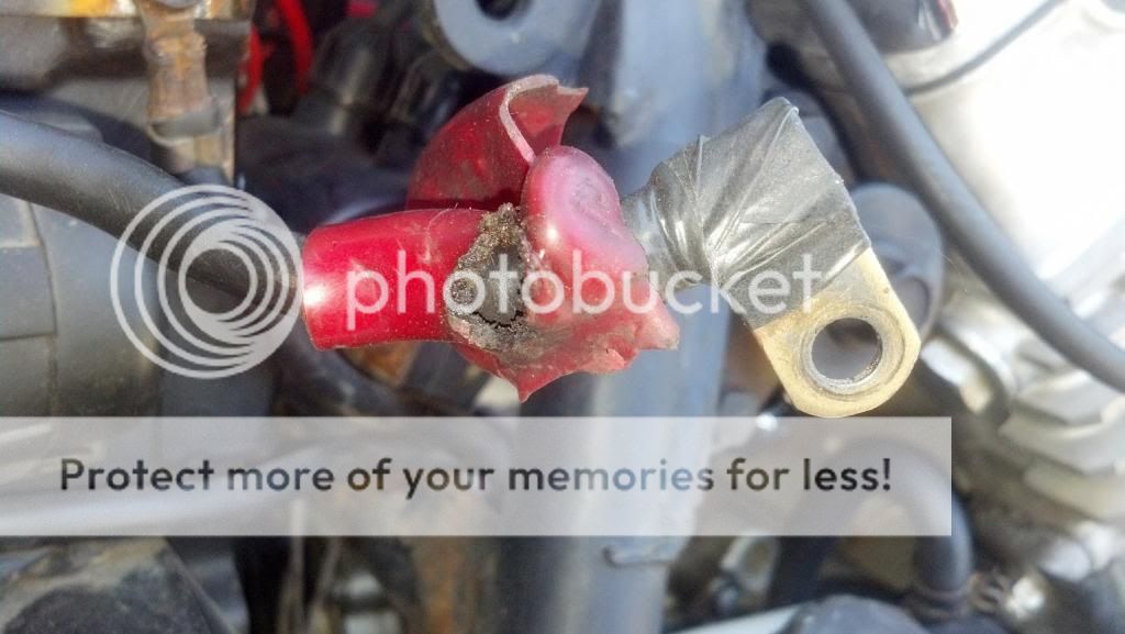

Soooo...
appears that the issue is with the battery. From what I can gather as seen in the photo below, the battery must have shifted and caused the positive terminal to short out. When I went out this morning to check it with my multimeter, I couldn't get any reading at all. tested on my other vehicles to be sure that the meter was working fine. Looked closer at the battery saw the melted red plastic safety cover. disconnected the terminal and wrapped the electrical tap as it is on there now and pushed the red plastic back up to help hold the tap on.
Until now, I had never felt the need to get a replacement battery strap to hold the battery down.
With the battery properly seated and terminal reattached, I got a reading of a whopping 6V. Hopefully it'll take and hold a charge. Battery is practically brand new, bought it over a month ago. If not, should be able to get it replaced under warranty.
Ndr is offline

Soooo...
Glad you found the issue with your battery cable.
With any luck, your battery will charge up ok.
(hopefully your R/R is still ok)
Yeah, I hope so too, I'll be giving a full system check once the battery tops off, or I get a known good one in there.
